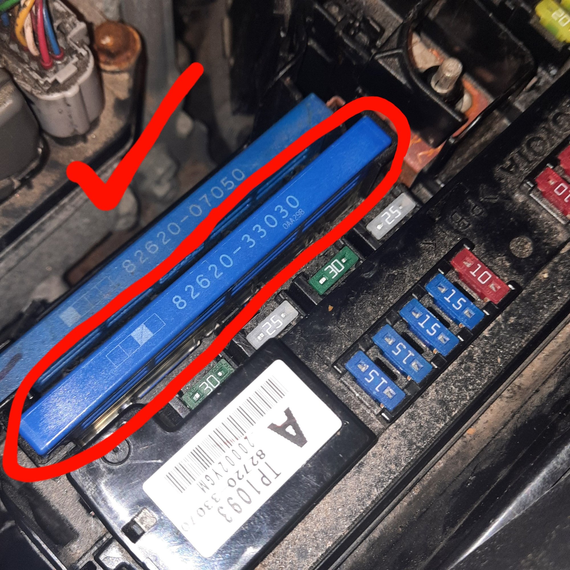

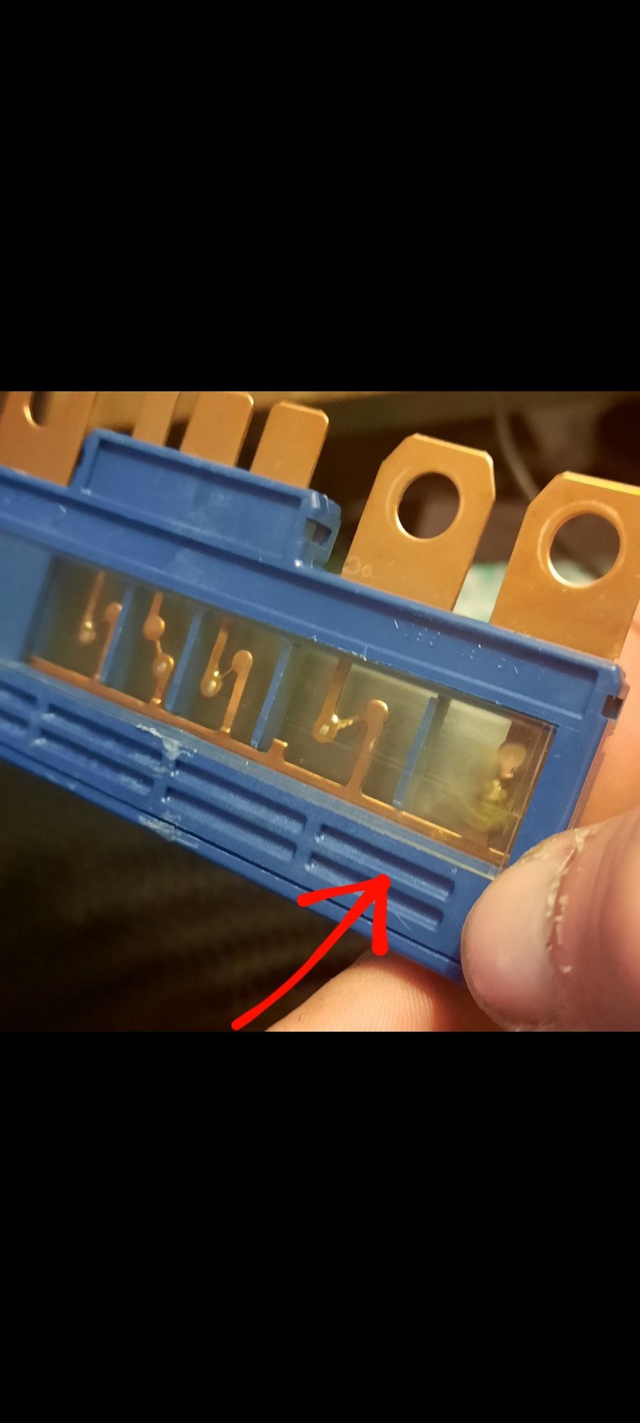

Been a couple days since I've posted, my apologies. So I discovered I had a blown one of the main high-amperage fuses in the under-hood fuse/relay box. If you're sitting in the driver's seat, it'd be the fuse box directly behind the dash gauges and a bit to the left. It was a long blue cartridge style fuse that had part number 82620-33030 written faintly in white ink on it. I've seen them referred to as "fusible links" but I don't know if this is technically correct. The jury still out on that lol I have no clue what happened in my cars particular case, but I guess this is common when someone either connects battery cables or jumper cables incorrectly, or does something wrong when installing an alternator. Since there's no alternator on my car, I need to find out what else could have caused this. Thankfully, everything I've read says it could only be the result of an issue with the 12v system and not the HV battery.
I got very lucky and found the same fuse replacement (OEM Toyota brand) on Amazon for a reasonable price w/ next day delivery. So far so good.
Unfortunately Installation was nowhere near as hassle-free.The entire fuse box has to be more or less dismantled, as they are a bolt-in design and quite difficult to access. .
