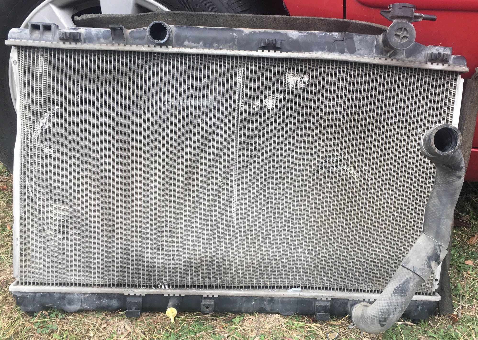

Sorry if this is already covered in another post. Any info or direction to helpful posts will be very appreciated!
I need to replace radiator but cant find one without oil ports on the bottom like this one? Are they no longer produced like this?
2008 Toyota Camry Sedan (VIN starts w 4) 2.4L Hybrid A/T

Toyota lists the radiator P/N 16400-0H240.
Amazon
Amazon
Aftermarket radiator companies may not make a hybrid version. One can use a radiator with ports and plug them.

Thank you! I assumed that but wasnt sure.
