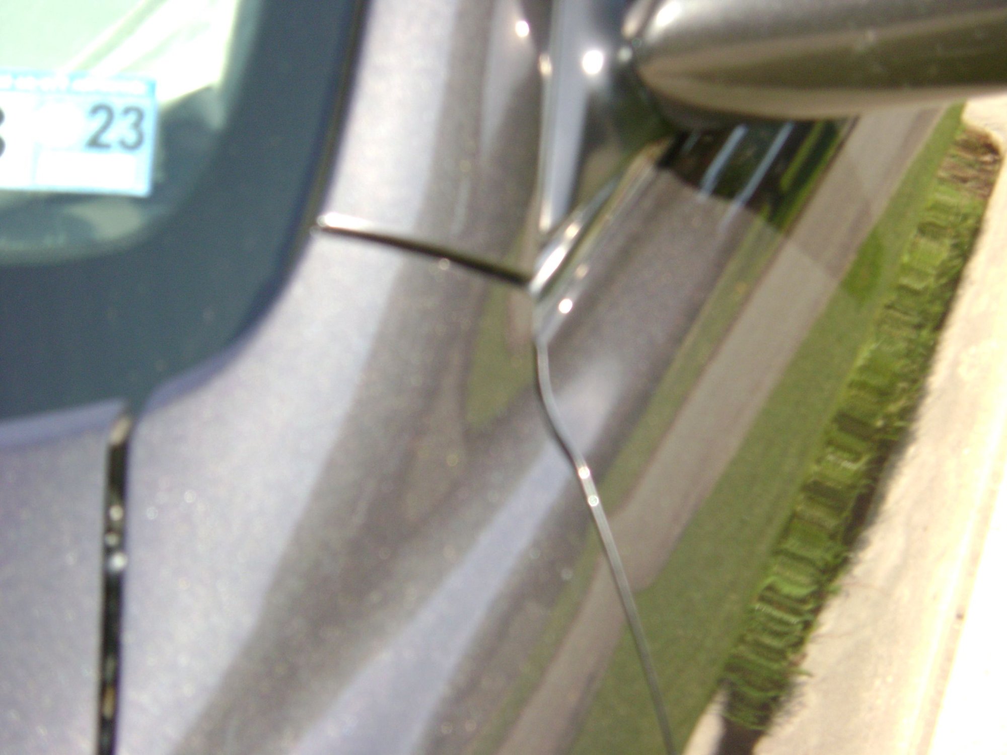

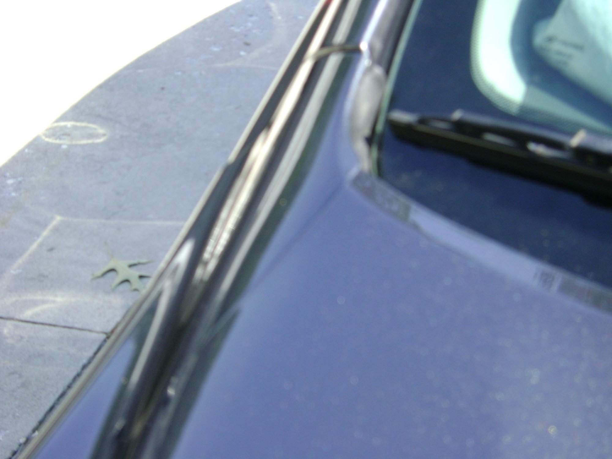

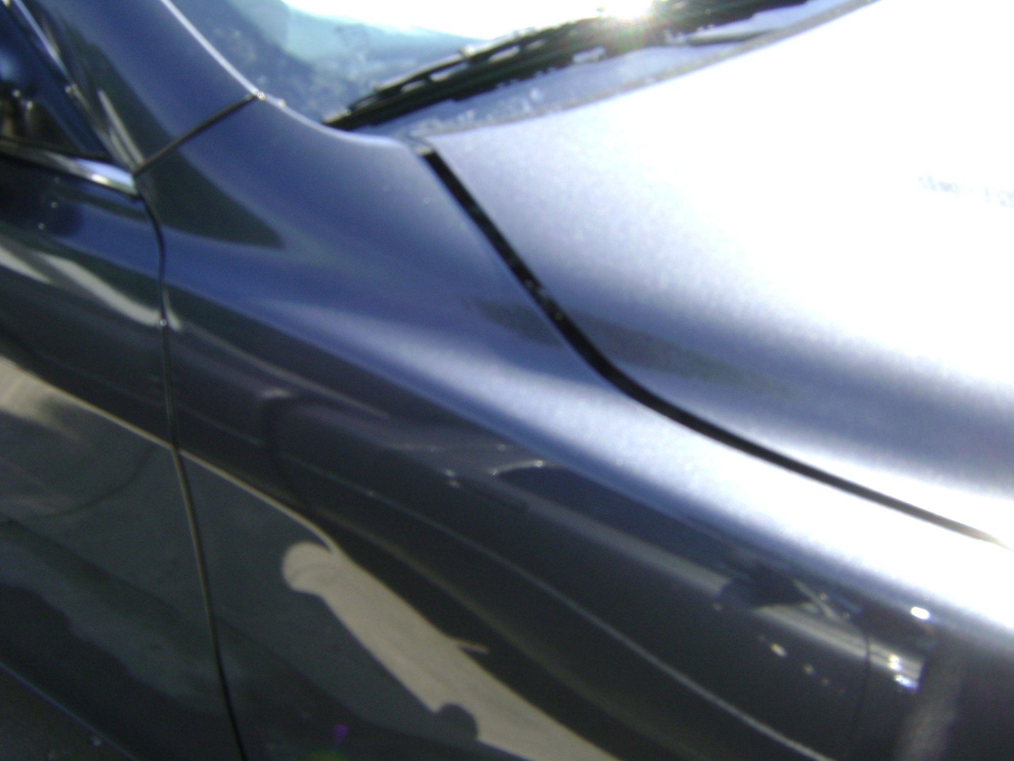

The hood is now 1/2 inch or about 13mm above the fender/body line. I have added some pics for folks to review.

Hood Right rear raised
(Kinda blurry) The rubber seal that does not fit
Right side expansion joint fully closed
Left side Hood and expansion joints, normal as designed
