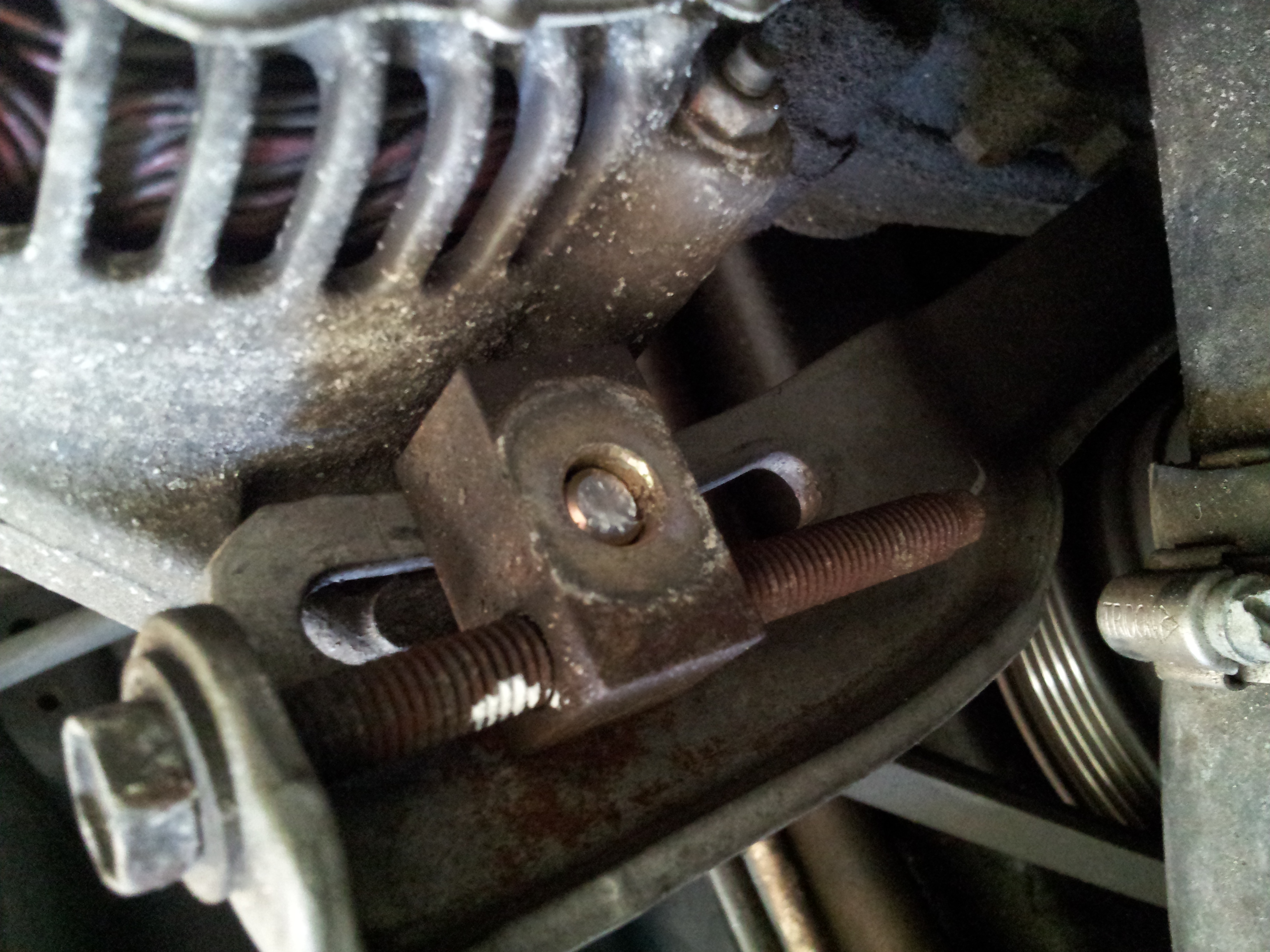

HELP! OK looks like I messed up, I was taking off the Alternator adjusting bolt and i snapped it off.
I thought I had broke it loose but I was wrong as you can see from the picture.
I just started the project today and was about 15 minutes into it! Not good!
I was trying to remove the alternator completely because I am installing a new water pump along with the timing belt.
So are my choices to try and drill it out? I have some of those screw remover bits where you drill first then swap bit to unscrew.
I also have a tap & die set.
Or can I try and take off the alt bracket. I do have the pivot bolt out. If I took the bottom bolt off the alternator bracket would that free up the
belt? I assume it would be easier to work on it off the car. I have never snapped off a bolt before - its always been a big fear of mine.
Does that adjusting bolt actually go into the alternator itself or does it just wedge itself some how against the bracket?
Maybe I should be buying all new bolts for this? The alternator and parts are all original. I had sprayed everything down with PB blaster a while ago but maybe I should have given it more today but it seems like it would be hard to get much into those threads anyway.

Old Oct 20, 2017 | 04:28 PM
The long bracket (adjusting bar) that the "pivot" block bolts to is attached to the engine at its bottom end.
The pivot block bolt attaches the alt to the pivot block. The adjusting bolt goes through a mounting eye on the alt.
The lower alternator mounting hole on the alternator flange bolts to the engine block.
To adjust belt tension. The lower alt mounting bolt and pivot block bolts need to be loosened. If the lower alt bolt is not loosened, the alt can not rotate to allow the belt tension to be adjusted.
The bolt snapped at what location? At the pivot block?
Do you now have the block pivot out of the car? If not, unbolt adjusting bar from engine and remove the bolt holding the pivot block to the adjusting bar. Then remove bar, block, broken bolt from car.
The threaded tensioner assy is used to set belt tension. Once set the pivot block is tightened down and the lower alt mounting bolt.
The tensioner assy is not needed to adjust belt tension. One can use a pry bar to force the pivot block to slide to on the bar to adjust belt tension. Then tighten the block bolt, alt bolt, etc.
If the bolt broke inside the block. Apply penetrating solvent to the threads/block. Rotate the bolt out as much as possible, then apply solvent on the newly exposed threads.
Then rotate the now sprayed bolt back into block. Repeat the bolt screw out/solvent on new threads/bolt in routine until the bolt is free or it is not possible to continue.
If the head of the bolt is broken, use vice grips to rotate the bolt.
