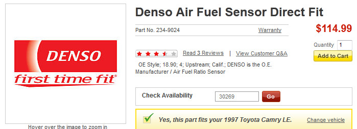

One issue has been with using Bosch replacement sensors in Camry. In some cases they can cause the CEL light to return. Recommend Denso or Toyota OEM. - Denso A/F Sensor: here's a quick look at it from Advance Auto Parts (my current fav parts store). $115 not cheap for a part.

- How-to replace the sensor
- You don't need to pull anything out of the car. Slide the drivers seat all the way forward and look under it the will be a slotted black plastic air vent the connector for the rear O2 sensor is just below that and is snap to the sheet metal. If you release the lock tab to the connector the pigtail will come out though the hole in the body. Then fish the new pig tail in through the hole and reconnect it. If the clip that holds it to the sheet metal breaks don't worry about it. The carpet will keep it from rattling.
