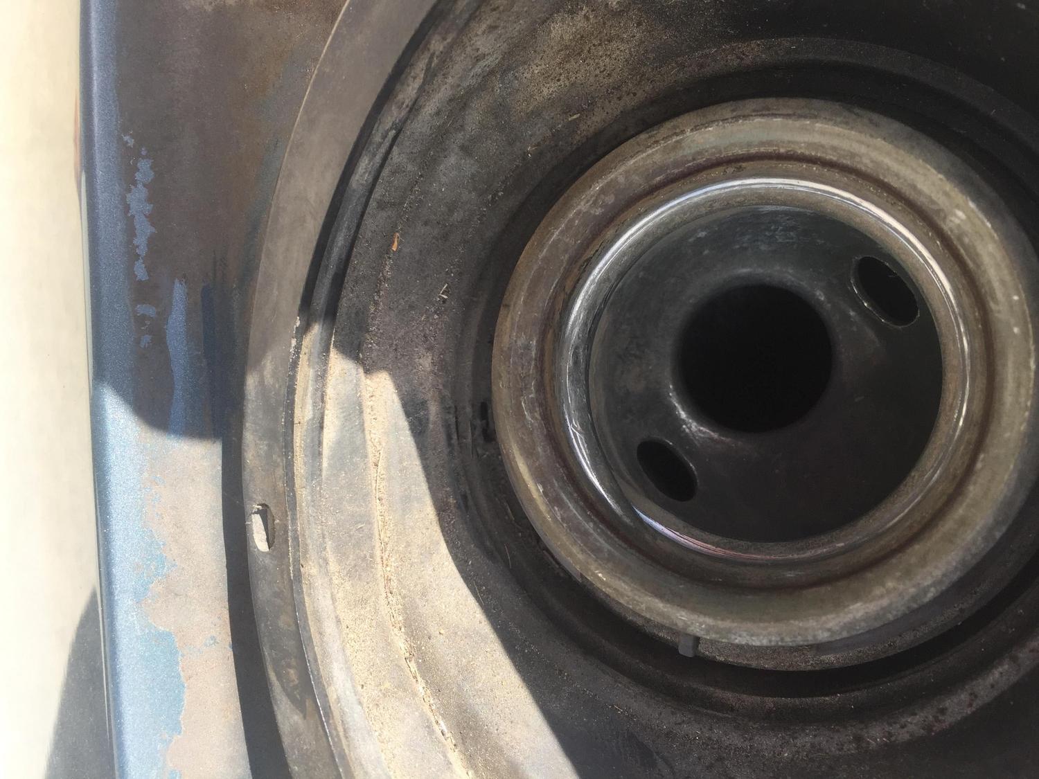

When ever i unscrew my gas cap it doesnt make that sound when relieving air pressure. There is nothing. Also, I noticed a small hole in the rubber area right below the gas cap area. Could these two be casuing these problems.
