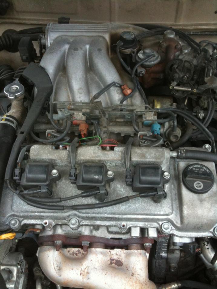

I wanted to add to this for future reference about the V6...the VSV is located on top of engine under that little engine cover in front of EGR over throttle body....there are three but the one with the vacuum tubing coming from the modular into the VSV and out going to the EGR is the one the others are for other systems thus totally unrelated. After speaking with a mechanic I learned that ohm testing needs to be done by removing part and adding DC voltage like that of a car charger...turning car on doesn't give you true ohm by what I was told anyways I gathered this from that the VSV is closed and when asked mechanic told me yes so if you can blow thru it the VSV is stuck open..I cleaned it out prior to reinstall and testing and it blows thru..I am having it DC powered to test it later this morning afternoon. I have a thread where a member posted info on how to clean it..(VSV) the ohm range of a working VSV according to Haynes Manual is between 33-39ohm.
#14
It appears my VSV is defective. I took it out and if was told one can't blow thru it..which mine does....looks like this might be my issue. There would be no point to take the VSV apart again since if not powered the VSV stays shut thus can't breath through. The ohm test is next once I get 12 volt power other then the car.

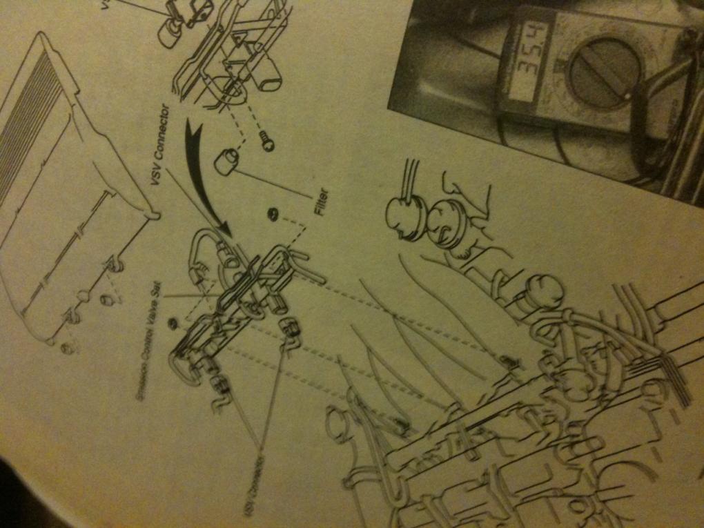

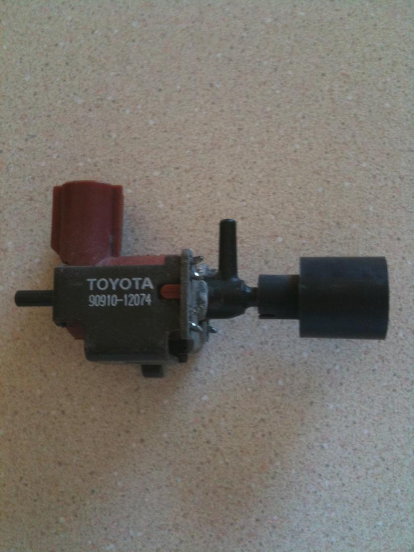

Is the VSV you refer to shown in the photo?
Does the part have two small vacuum hoses connected to it?
Does one hose go to what looks like a can on the EGR valve (the EGR having 1 vacuum hose attached). The other hose going to what also looks like a can type item that is located next to the EGR valve (this can has 2 vacuum hoses attached).
If so:
The ohm reading should be 33-39. This is with the electrical plug to the part removed.
There should be no continuity between the valve case (part that is steel) and either of the electrical terminals on part plug.
When the valve is NOT powered, air should flow between the port (tube) nearest the round barrel on one end of the valve (let's call it Port A), and the port at the other end of the valve (Port B). Thus Port A is connected to Port B.
When the valve IS powered by 12v DC. Air should flow between Port A and the round barrel (let's call it Port C). The round barrel is actually another port but it vents or is open to atmosphere. The round barrel is a screen/filter to keep debris out of the valve and hoses.
When the valve is powered, Port A is no longer connected to Port B. Port A is now connected to Port C, which is vented to the atmosphere. Air should NOT be flowing between Port A and Port B, but from Port A to Port C.
Check airflow between all the ports as stated above.
When the VSV is powered, the EGR system is off.
If the valve has 3 hoses attached to it, post back.

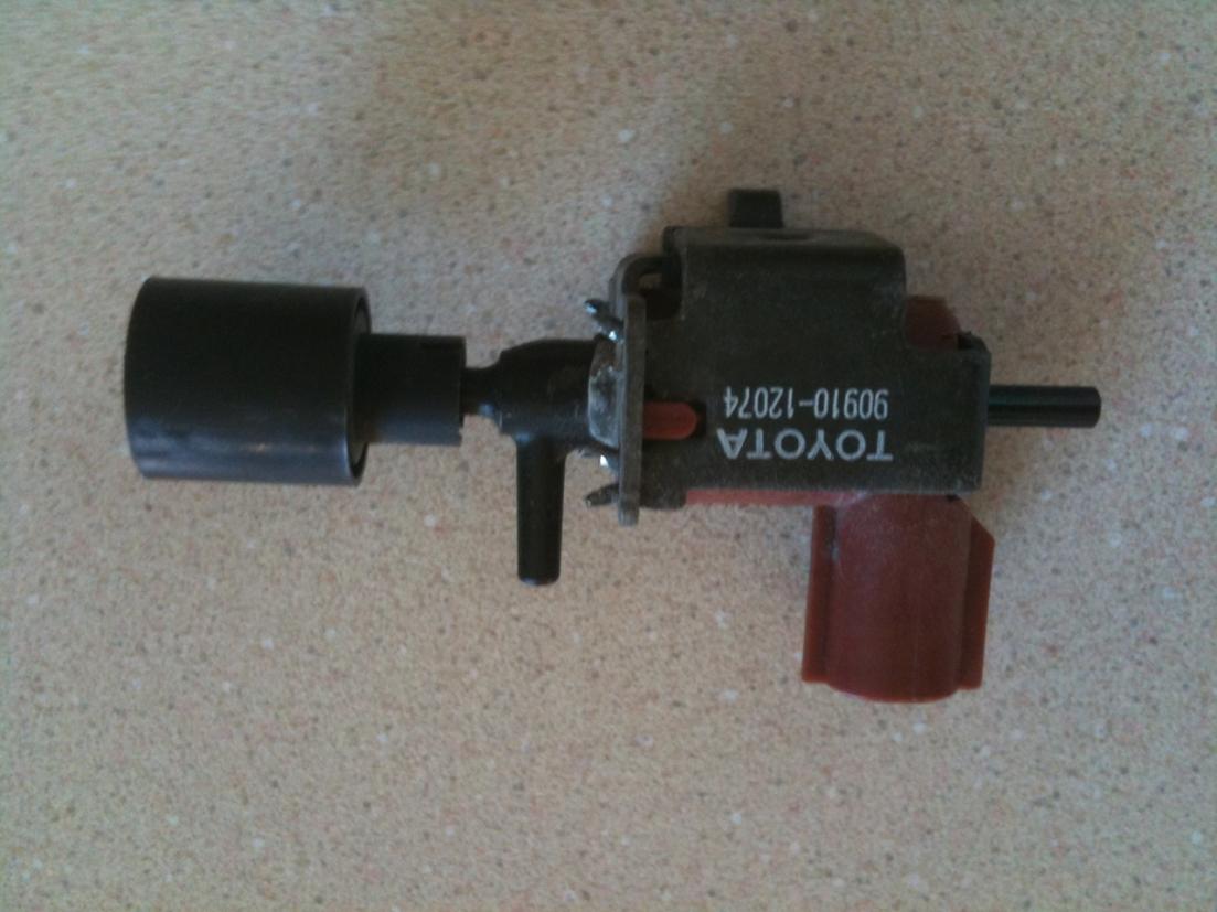

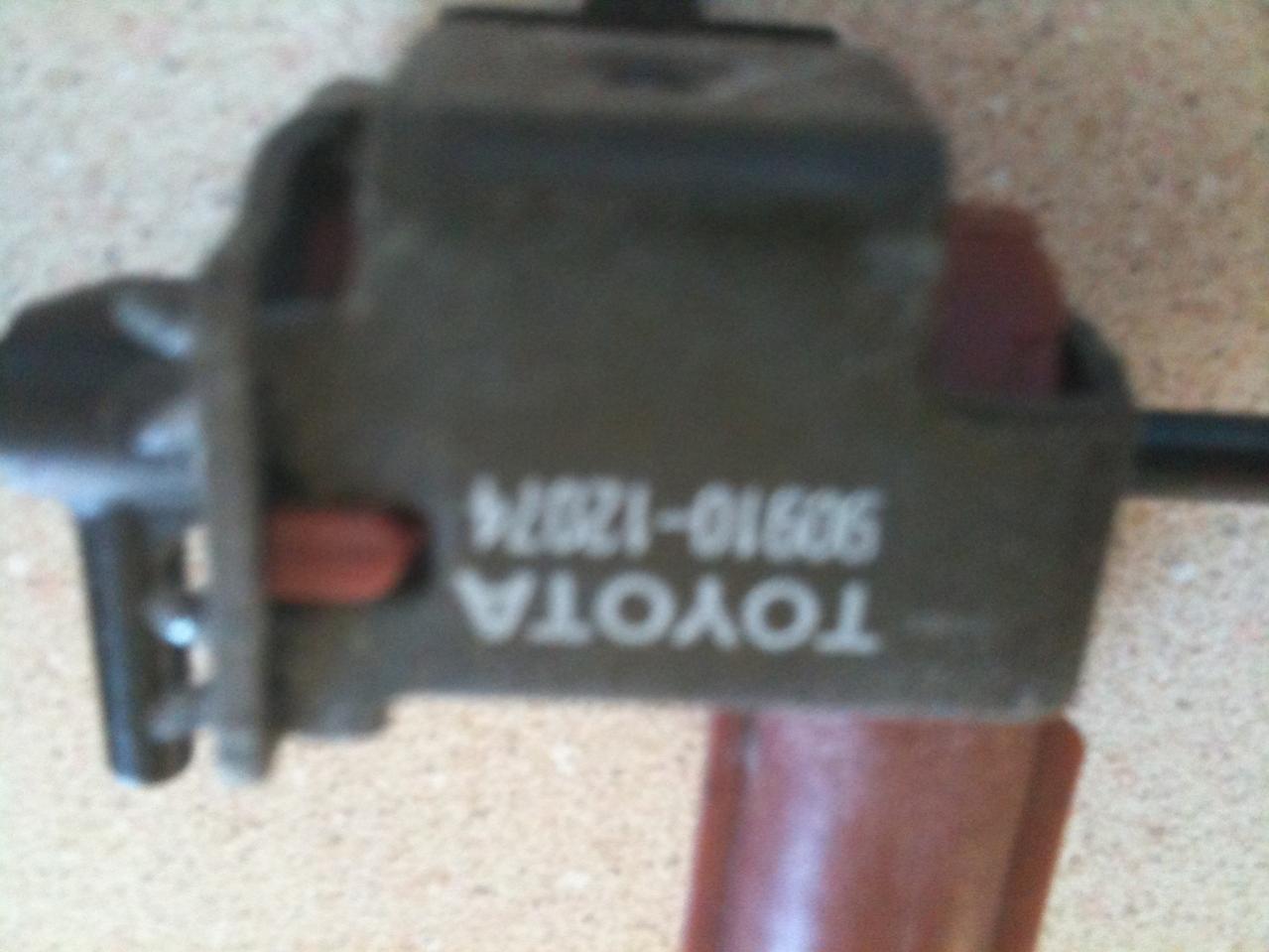

yes the vsv you mention is same I speak about. I ohm before but with power and plug inserted and got a 38.95. The ports A and B are the only 2 I am testing not the one with the filter thingy on it(roundish) with and without power I can breath thru port A and B thru either direction.
#20
This is it in picture. I used a vacuum hose attached to side where plug inserts facing west I call that port A...then another vacuum hose on end facing north between roundish filter thingy and description saying "Toyota" that's port B.
