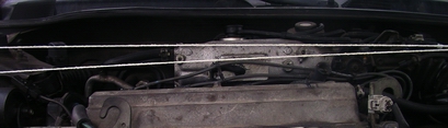

1997 2.2L with A/T 204K miles....The problem started 6 yrs ago when I had the 4 motor mounts replaced at a small shop. I noticed that the torsion rod mount on top was twisted and off-center inside the engine mounting bracket and that the engine appeared to be sitting about 1 inch lower on that side (than it had been before the repair). The shop manager told me they used the right parts and it wasn't their problem. I quit going there and have been doing my own repairs since. 2 years later the mounts were severely damaged and I replaced all of them myself. They need to be replaced again and I would like to figure out what is wrong( I'm retired now and have the time to fool around with this).Today I installed new motor mounts from Rock Auto Parts and immediately saw that nothing had changed and I went ahead with a my plan to shim the back mount until the engine was level. This required a 5/8" thickness of slotted washers; the holes in the torsion rod mount lined up perfectly with the bracket holes. So far , the vibration at idle has almost disappeared. Here's what I got from Rock Auto.."This is the first reported issue of this nature for this part number. The manufacturer verifies that this should be the proper part (A7219) for your vehicle (with the automatic transmission). " I will let this go but I am still peeved at the shop that started all this. I asked to see the old parts immediately but they had already disposed of them.

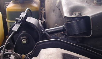

Crawled under the car yesterday and found that the trans mount is fastened to the same welded frame as the front and rear mounts. I snipped a photo off the internet showing what mine looks like. There is no adjustment possible that I can see for the positions of the 3 weight-supporting mounts
. I can tell you positively ( after the repair 6 1/2 years ago) the engine had dropped enough so that the torque rod mount was rubbing against the brackets...fellow at the shop put the mount in a press and bent the short rod 20-30 degrees so that it wouldn't rub the bracket
I've had no problem with the alignment replacing the last set of tires after 5 1/2 years of use with plenty of good even tread left. Car has never been wrecked..
