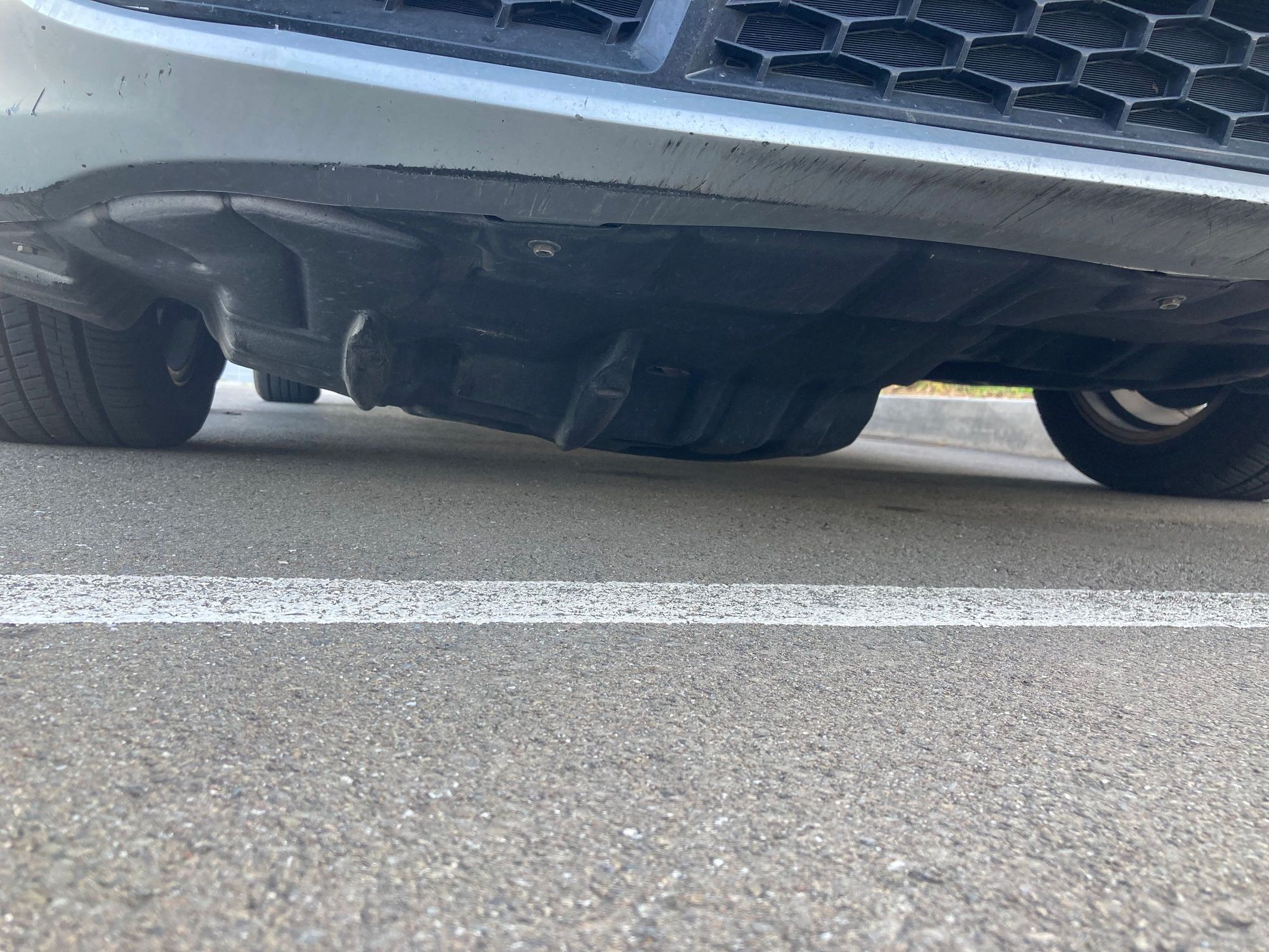

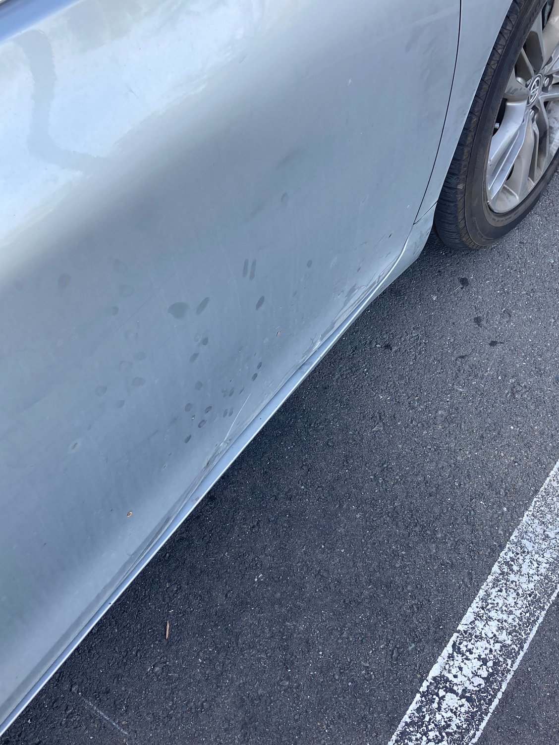

I had a small car accident about half a year ago where I got hit at the front door on the right side by a motorcycle. My Camry 16 got some damage from the accident as shown in the pics below but it runs fine so I've been procrastinating the repair till now.. The driver of the motorcycle didn't have insurance IIRC and the police never release a report on the accident.
What repairs do I need for the car? Since I'm paying 100% out of pocket so I'm trying to save some bucks here. I think I can leave the dent on the door (1st pic) as it is since it doesn't affect any functionality or reliability I guess. For the 2nd pic, I'd like to have the lining around the wheel aligned with the shell. It looks flimsy and I don't feel good to leave it as it is. The 3rd pic really looks terrible but it's just the shell dangling, I guess a bolt or two fell off in the accident. Fortunately there's some clearance so I don't hear it scrubbing the ground when driving. Sorry if I call the relevant parts by the wrong names since I don't know much about cars and I'm not very good at English.
Are the damage in the 2nd and 3rd pics able to get done at an auto repair? Not a body shop? To minimize the unavailable time of the car, I'm trying to get it done along with a regular maintenance (I've put 15000 miles on it with just oil changes) at one place. New to this forum and appreciate any information and help. Cheers.

The door is a body shop job.
The clip that holds the plastic inner fender liner appears to have broke off. If you can find another clip you could remove the old one and replace the clip you yourself.
Any plastic handing under the car is a result of the plastic and perhaps metal fasteners pulling out of the plastic. You can buy a new lower plastic splash shied or fasteners and fix it your self. Splash shied get damaged often.

Look under body-splash shield and fender liner
There can be cheaper aftermarket parts available.
If the shield under the car is dragging, pull it up with wire or string running from one of the fasteners or hole in the shield to some place in the engine compartment.
