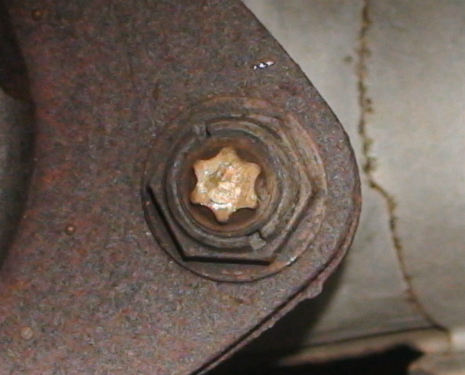

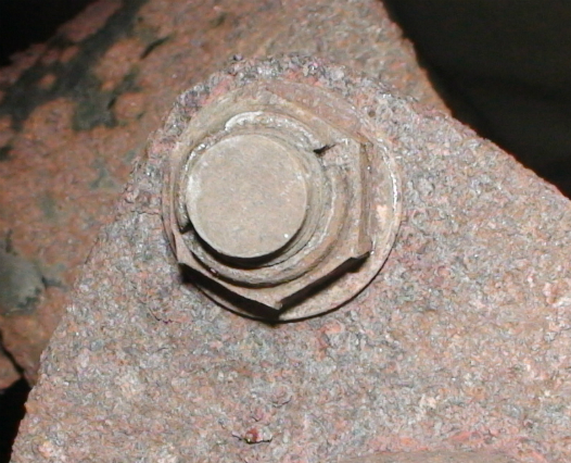

my thoughts on your pictures
the exhaust system has large holes .. the nuts are not welded to the pipes section
its a torx bolt though to the other side
the other side is a plug with the torque bolt thread internally to tighten the joint
the plug nut is already rounded a bit
the plug side may need to held with a spanner or deep socket or it may just spin
the torx bolt . if it is head is raised above the nut .should be the one you try to undo ....
the larger nuts should have loose flat washers below each side ...
why the nuts look different
the two larger nuts are the supports/guides for the torx bolt and plug fastener
Attached Thumbnails Header Pipe Removal - 1995 Toyota Camy 6 3.0 liter-plug-side.jpg   Header Pipe Removal - 1995 Toyota Camy 6 3.0 liter-torx-side.jpg

Thanks, I have all the main bolts loosened. The hangers were easily loosened.
There is only one to loosen and have not figured it out yet.
If you look at the previous pictures it is the one that does not have a female torx/nut through the bolt but just a nut on bolt. Tried to unscrew bolt with socket but did not work and do not want to break bolt. I think there is a nut behind it I need to unscrew. Will tell you how I figure it out.
Parts arriving today for weekend install. Fun Fun
I know this a long thread and appreciate everyone's help. Will summarize the work at the end with more pictures.
Old Mar 10, 2016 | 08:57 AM
  #20
wdc123's Avatar
Joined: Oct 2015
Posts: 425
Default Here is the picture I was talking about.
