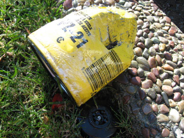

Let me get this straight, you're telling me i cannot do this? Name:  IMG_5223.jpg
or perhaps you're talking about something i am totally unfamiliar with.

Yes. The 07 Camry does not use the can filter. The replacement filter is just the paper part of the typical can filter. There is a steel housing that the filter goes in. You do not replace the steel housing. It is a permenant part of the engine, and you can not put a screw driver thru it. To change the filter you must unscrew the housing. Hence lies the problem. You must have to have a special tool that will fit it. I can not find a quality tool.
