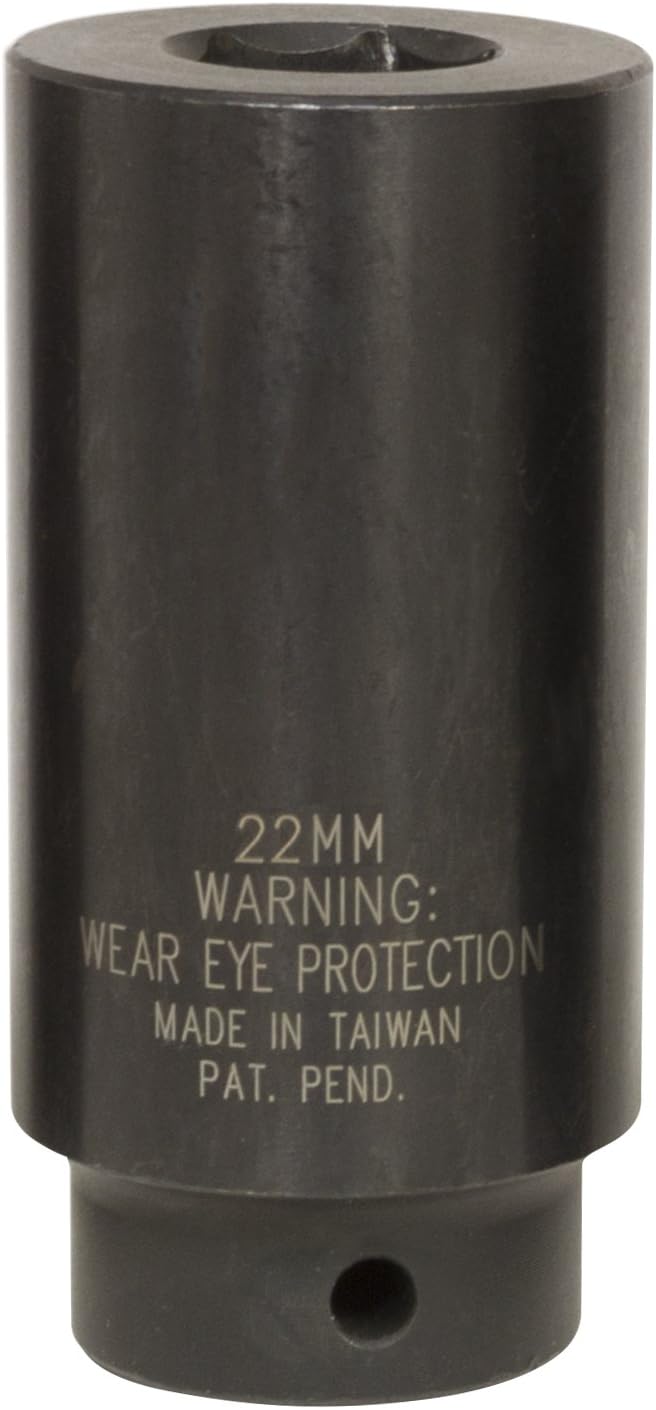

Could not remove 22 mm bolt from crankshaft,
Tried 18 V Impact , nothing then 600 foot lbs 1/2 inch air impact, nothing.
Looked at video and they use a 22 mm Harmonic Balancer Socket lisle so going to buy it.

Crank bolt torque is something like 159 ft lbs.
An impact wrench can not be effective.
Get a LARGE breaker bar such as a 3/4 inch drive from Harbor Freight (low cost). Use their adapter (low cost) to reduce the drive size to 1/2 for the socket. Then get a section of pipe to use a force multiplier. If you are not using one already, fabricate a device to hold the pulley stationary at the inner pulley. The pulley has threaded bolt holes to attach a tool to that has an arm. The tool bolts to the pulley and the arm can be wedged against the chassis..
Just removed harmonic balancer bolt. As said before used 18 V Impact wrench with 22 mm impact wrench socket and did the same with 1/2 inch impact wrench with 600 ft/lbs torque. Your suggestion is good but had already bought this new impact socket.
Now used Lisle 77110 22 mm Harmonic Balancer Socket. Amazon $26.00. Picture from Amazon. Next day ship. Would not turn with 18 V Impact but spun off in 5 seconds with air impact. Will keep you posted. It is a solid socket hence gives the air impact more torque.
