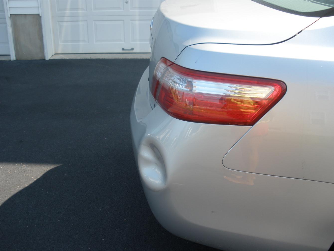

Hi, sorry if this isn't the correct forum I'm a newb.
Someone hit my car no note nothing. Is it fixable without replacement.
(pictures attached). If not how much would you assess the damage to be.
Attached Thumbnails Please help- Car bumper accident-p7090261.jpg   Please help- Car bumper accident-p7090001.jpg

Absolutely yes. You can remove the rear bumper with just a few clips and screws.. then work the dent out with the help of a hot air gun. The heat will soften the plastic allowing you to push it back out. The longer you wait- the harder it might be to make the repair perfect.
