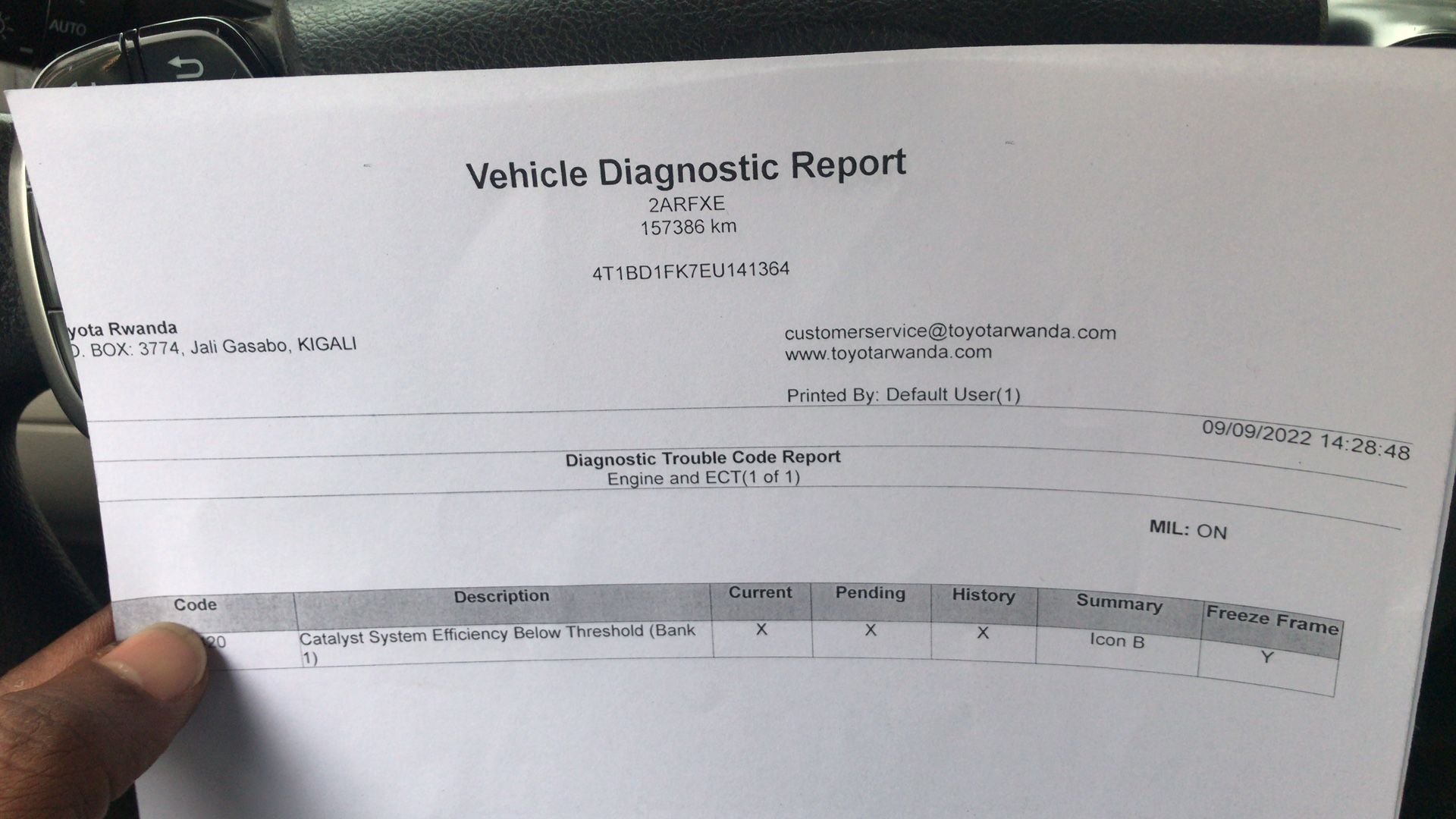

Hello guys, my recently bought Camry 2014 displays this error which shows 2 error on the car’s table. The diagnostic revealed the battery was the cause with one chamber damaged. Today I check the battery but the same is displayed. Advise, thanks .

The hidden code is this

Your thumb covers up one of the codes. Speculate the exhaust emissions converter is bad.
A Toyota brand replacement would be the best but it will be the most expensive. There are cheaper aftermarket converters. Try an auto exhaust shop.
The P0A80 means the main battery is failing. The battery is composed of "cells" and it could be just one just one bad cell.
You may be able to find rebuilt batteries at lower prices. The Toyota dealer however typically will only sell a new battery and be the most expensive.
Suggest you start shopping around for a replacement battery or decide what to do. If the battery fails the car will not be able to be driving with gas engine.
Check the cars warranty for both the converter and battery. Assume it varies with country. In the US it seems to be 10 yrs or 150K miles. The converter is 8 years and 80K miles. Your warranty may be different because of country.
