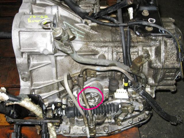

here is a picture of an actual transmission
in this pic you can see the piece in question

The is the cover as described in the previous post.
Behind the piece is a piston, looks like a round disk the same diameter as the hole. You should see a rod end protruding from the exposed side of the piston and a snap ring holding the rod onto the piston. Make sure the piston is still installed.
For the cover you will need to obtain a clip that looks much like item DHT at the link below. Might start with a Toyota dealer although this is a standard part if you can find someone that sells it.
The plug installs, then is pushed in. The hole has a groove around it. The clip is compressed by pulling the two open ends together with a hand tool to reduce its diameter then inserted into the hole/groove. Once the tool releases its grip the clip expands into the groove.
