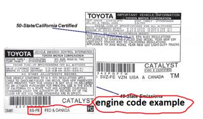

can you please tell me the engine code of your Camry , some model toyotas have a regular 30k plugs some camry's 4runners ,tundras ,etc, some models have a TOYOTA OEM DENSO 100K plugs, is your owners service guide said 30k replace plugs TOYOTA KNOWS BEST
Where would I find the engine code? The owners Maintenance Log is where it says to change every 30K, but that is generic for most every model Toyota car, not just this Camry. It is a top of the line XLE, what plugs would normally come on that vehicle?

Old May 9, 2012 | 04:32 PM
boricua's Avatar
Joined: Apr 2012
Posts: 121
From: pa
[QUOTE=bbqbyrds;71478]Where would I find the engine code? The owners Maintenance Log is where it says to change every 30K, but that is generic for most every model Toyota car, not just this Camry. It is a top of the line XLE, what plugs would normally come on that vehicle?[/QUOT
Attached Thumbnails when to change spark plug question-2011-05-31_213159_cat.jpg
