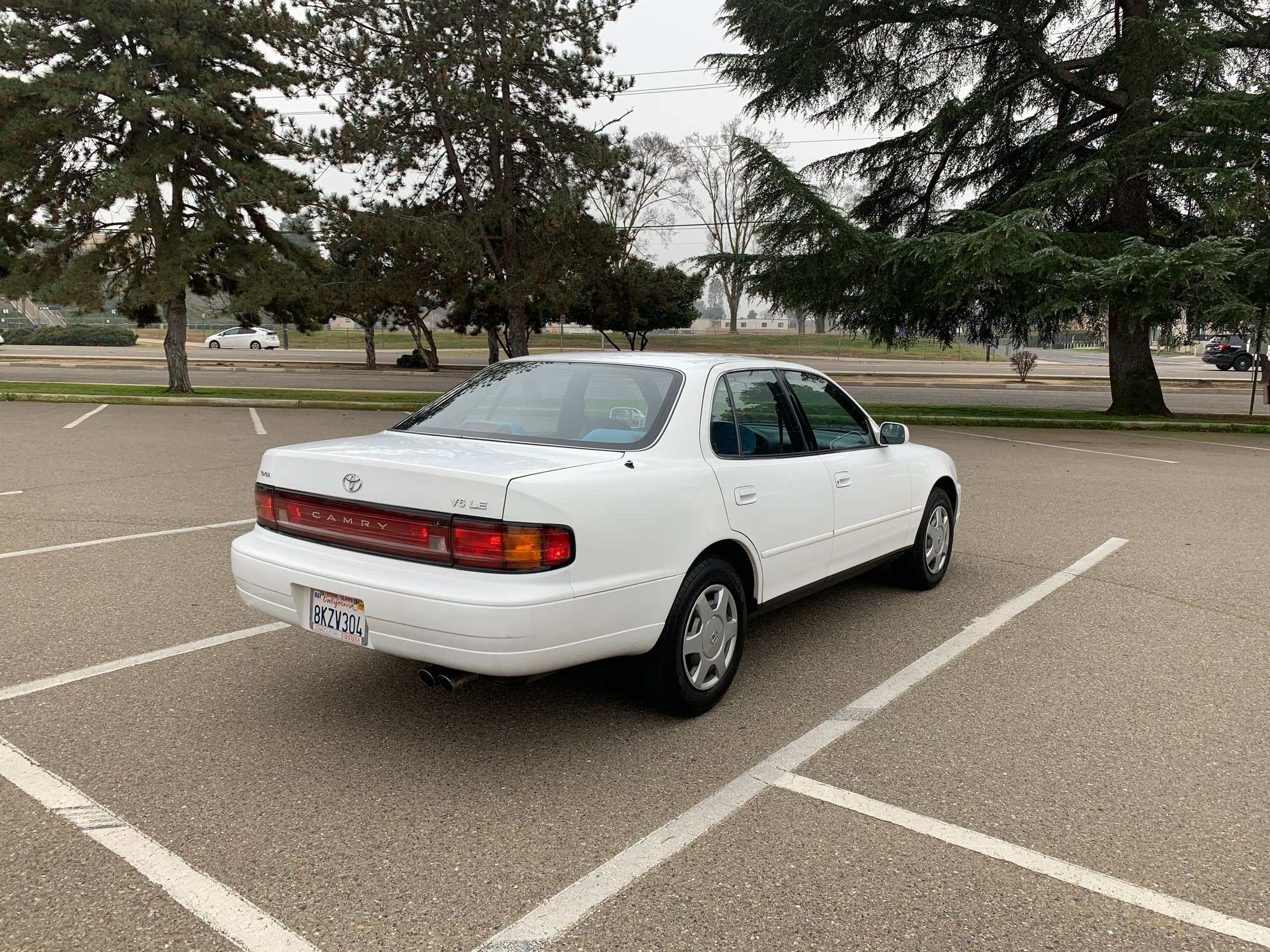

Hello I’m new to the page and just need help on my 1992 Camry Le V6. This one has the 3vz-fe OBD1 when I start her up (when the car is already driven for 30 minutes not cold starts) she starts like a cold start jumps RPM sometimes close to 3k rpm’s and warm up idles around 1200rpms. If anyone knows this problem thank you. Sorry I’m not every good at explaining.
