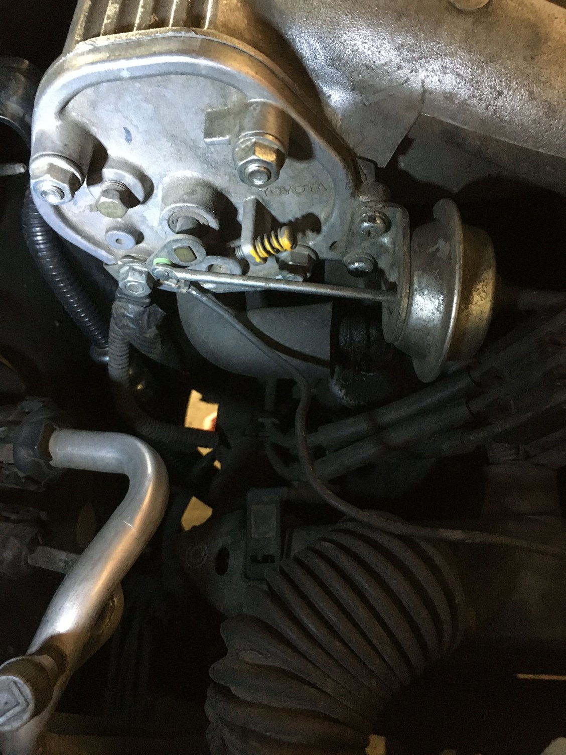

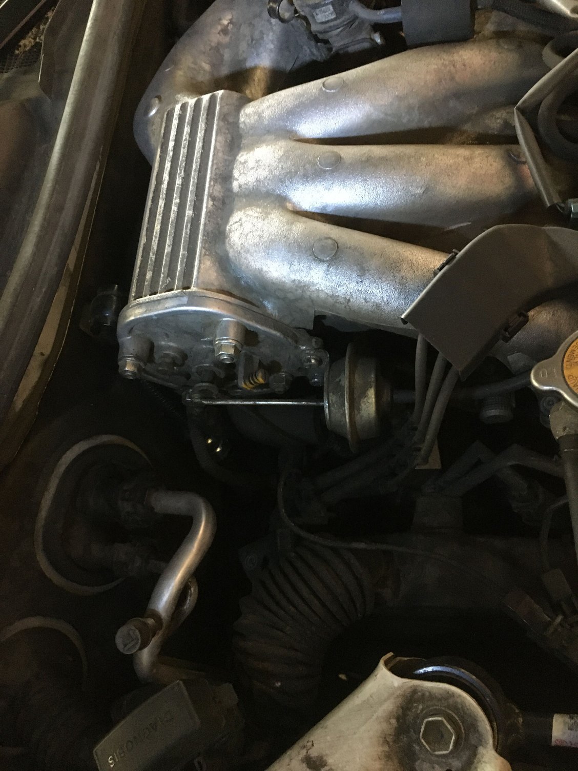

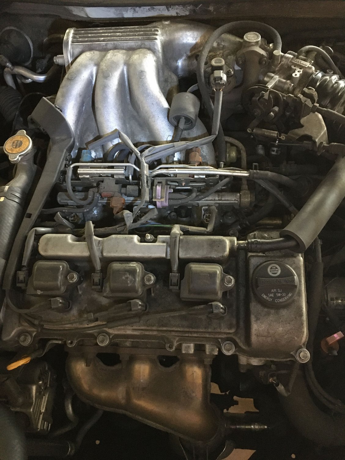

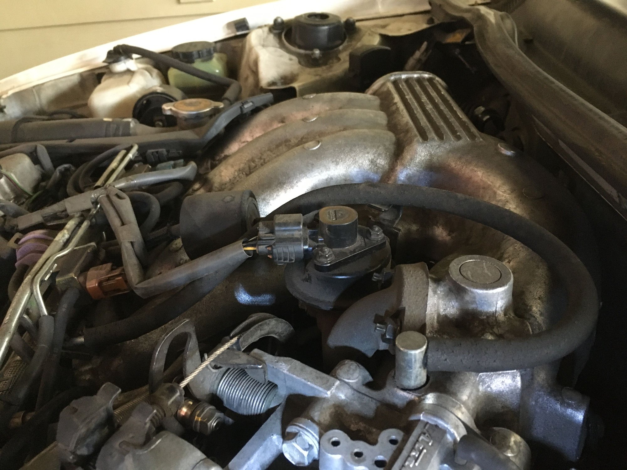

I am still unable to locate this "Bank 1 Sensor 1 is the first sensor on the exhaust system coming from Bank 1" for my 1999 Toyota Camry V6 car. Is it more to the Driver side or the Passenger side? Is it easier to look from the Top or from the Bottom of the car? Would you mind taking a photo with an arrow pointing to this "Bank 1 Sensor 1" please?
Jimmy
Old Oct 3, 2023 | 08:40 AM
Bank 1 is the cylinder bank closest to the firewall. Sensor 1 is the first senor on the exhaust system coming from the head. It is before the first converter on that exhaust system.
Find the converter nearest the the exhaust manifold on the rear cylinder bank. The sensor is located prior to this converter.
Old Oct 3, 2023 | 04:53 PM
jtliu's Avatar
Joined: Aug 2023
Posts: 17
Maybe I'm blind but can you tell me which of the 4 photos is this "Find the converter nearest the the exhaust manifold on the rear cylinder bank. The sensor is located prior to this converter." Would you mind marking with an arrow pointing to this "Bank 1 Sensor 1" please?
