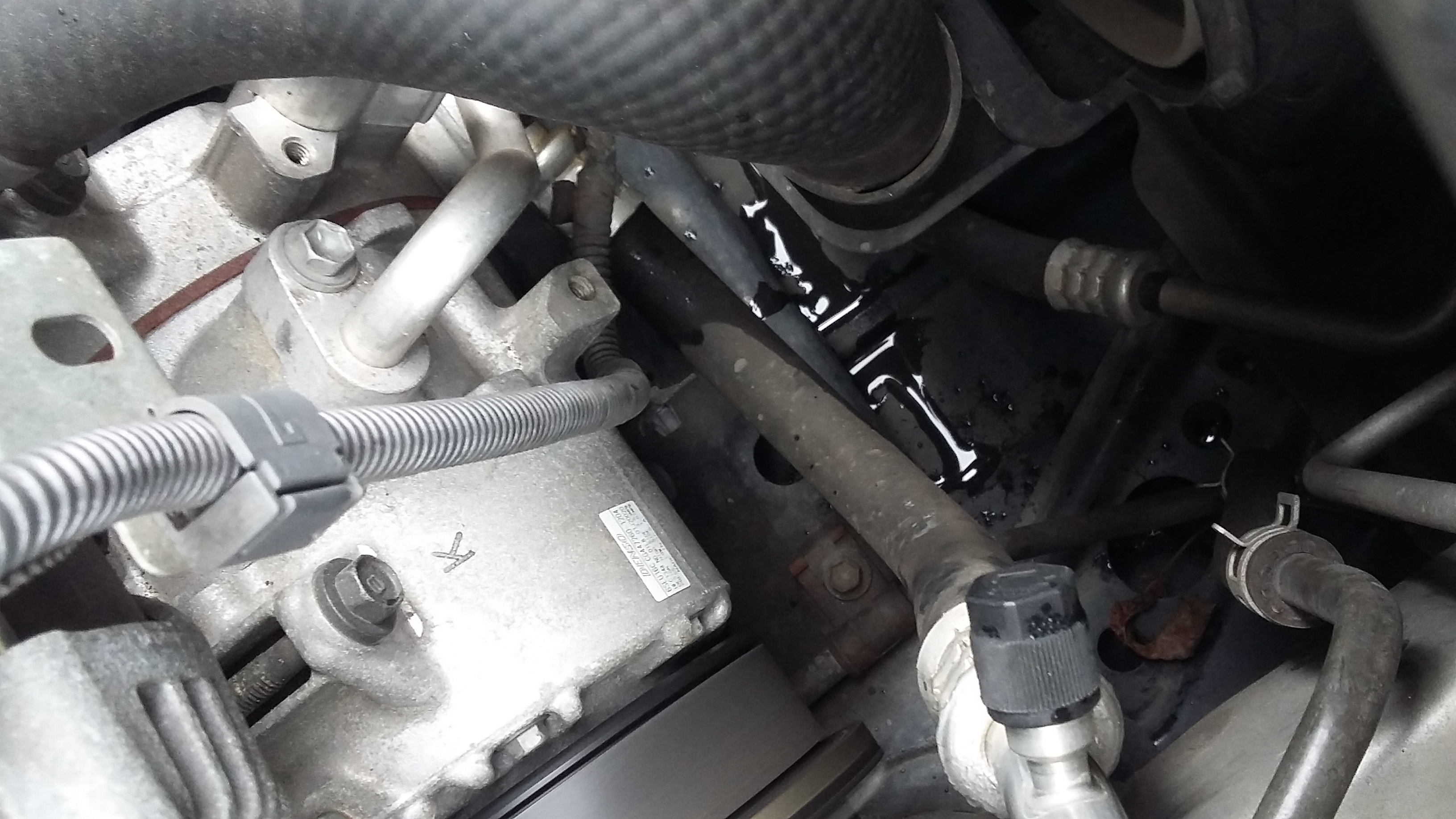

I noticed some dripping coming from the suction hose and I don't know if this is normal or something that needs to be fixed.
I attached some pics here
Attached Thumbnails suction hose dripping when a/c is running-20170814_153230.jpg
Old Aug 14, 2017 | 06:20 PM
Could be condensation (water).
Freon will evaporate quickly. However if having AC compressor oil in the system the oil will remain.
Put a sample on a paper towel and examine.
