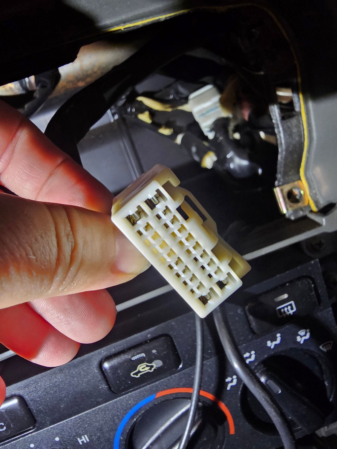

Default Wiring my Panasonic Radio to my 2001 toyota camry le
So I found the new
I need the male end that fits this.
radio end of the wiring harness that fits my panasonic radio. The problem I'm finding is that the male end that plugs to the car female end is impossible to find. I found the reverse or female end of the wiring harness for my car. But I need the proper male end. Do I need to cut the female end off and solder a new female end to fit my male end? Please help!
Old Sep 11, 2023 | 08:25 AM
The wiring plug shown is for Toyota radio having a remote amplifier. This means the amp is not built into the radio but located some place else in the car. If the new radio has its own amp then your going to have to do a lot of rewiring as none of the plug wires go directly to speakers.
Look around the wiring area of the plug to determine if there are other plugs perhaps taped over. The radio wiring without remote amp has two plugs.
Read the info at link below.
https://www.toyotanation.com/threads...rness.1376353/
