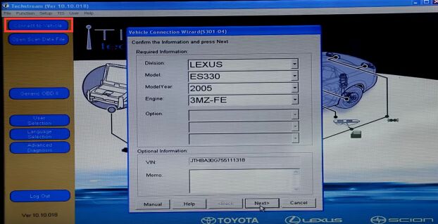

Step1. Buy a new key with remote, take out both new key and original key remote chip and fit the original remote chip in the new key shell. So you can use the new key to turn ignition on. Then connect the MINIVCI J2534 Toyota TIS Cable to car OBD2 port and laptop USB port. Open TIS Techstream software.
Step2. Click “Connect to vehicle”, it will show you car information automatically. Click “Next”.
