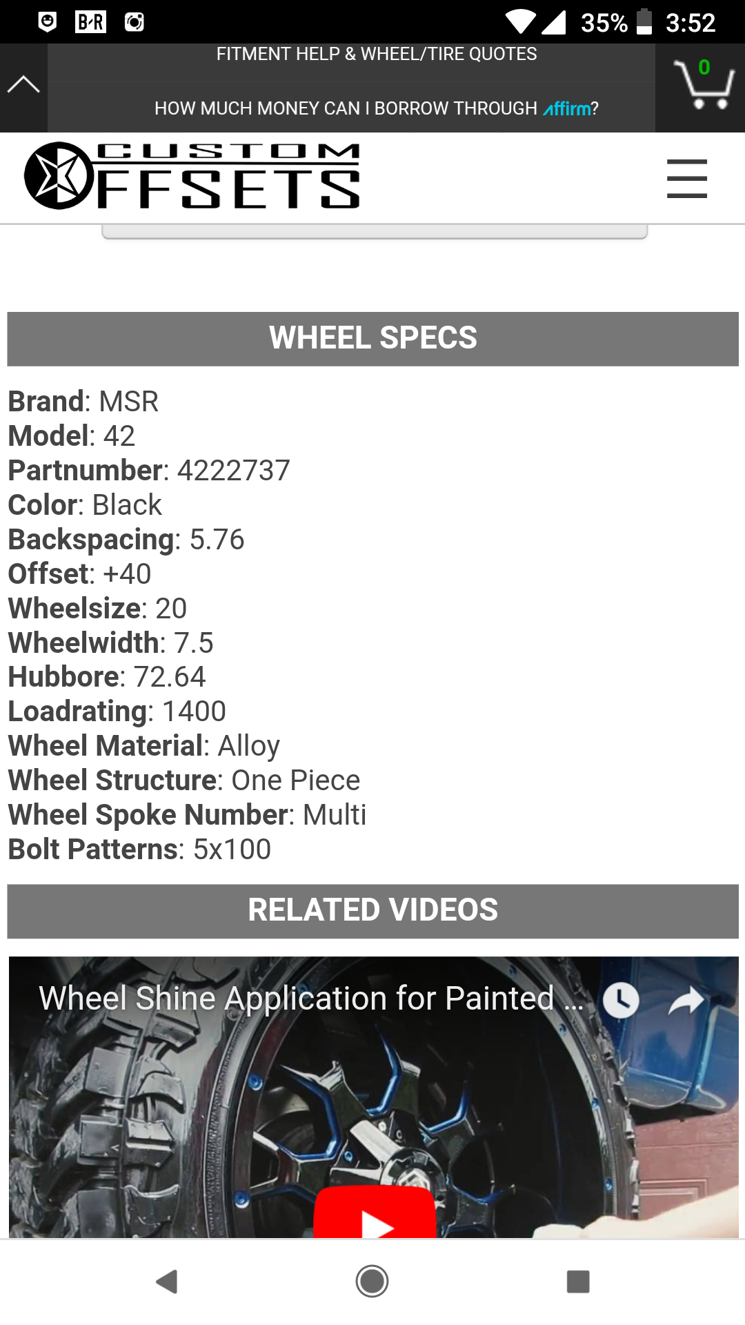

Thank you for your response. I found the same wheels online but not sure if the specs online are the same as the wheels my buddy has. I know he had them on a Honda. I've attached a pic of the specs I found online.

Per the link below, yes they will fit.
Camry uses the 5 x 114.3 bolt pattern.
http://www.caliwheels.com/msr-wheels...els-w-1995.htm
Click on 5 LUG MACHINED WITH BLACK TRIM in available finishes..
Suggest calling the business to confirm.
