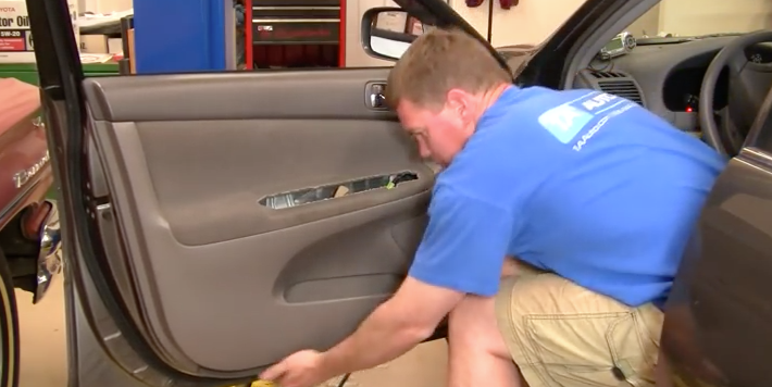

Step 2 – Remove four of the five screws holding door panel in place
Use a Phillips head screwdriver to remove the four of the five screws holding the door panel in place. There is one screw in the interior door handle, one screw covered by a grommet in the upper right-hand corner of the panel, and two screws on the underside of the door panel.

Figure 3. Remove two screws on underside of door panel.

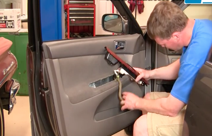

Step 3 – Remove door pull
Remove the rubber piece in the door pull, and then pull out the door pull. Unclip the connector and wires holding it in place. Position the connector and wires in the space where the door pull fits. Set the door pull aside.
Figure 4. Remove rubber piece inside door pull.
Figure 5. Pull out door pull and disconnect its two wires.

Step 5 – Loosen door panel
Grip the door panel along the bottom, then pull up and out. It should snap out of place, but it won’t come completely off just yet.

Grip the top and the bottom of the door panel, and pull up and off. The door panel should no longer be connected to the door by anything more than a pair of wires. Since there are wires still holding it in place, you can’t simply set it aside just yet.
Step 8 – Disconnect wires and remove door panel
Reach behind the door panel and disconnect the two wires by carefully pulling them apart. Once the wires are disconnected, the door panel will come right off.
