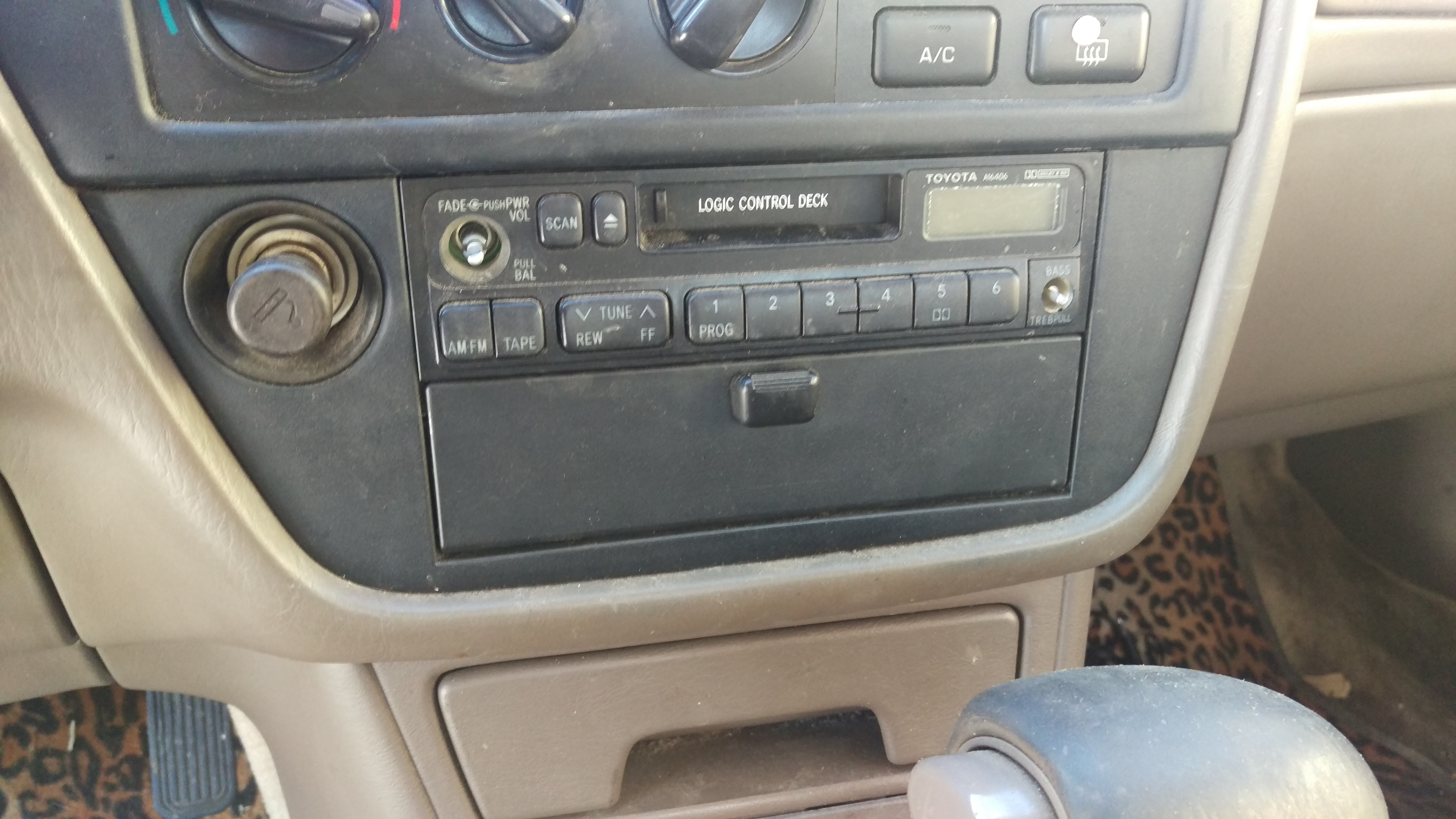

Tested the passenger speaker and it was dead. in need of a speaker I actually took one out of a box in the house and it fit perfectly
now I just need to figure out why the rear speakers don't work. I know one has a whole in it, I've seen speakers in worse condition work, but now I'm not certain this one works. If one rear speaker quits working, will they both stop working?

thank you for the picture
test both rear speakers the same way as that faulty passenger speaker
