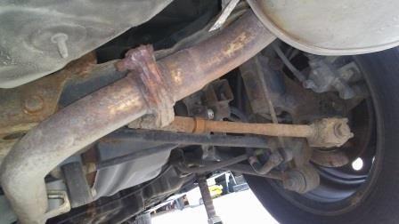

Hello, Working on the GF's (Darlene) car today and ran into a couple issues. Anyone know after market part numbers for the rear lower lateral link to knuckle bushings. I'm replacing bad lateral links on the 2007 camry 2.4 LE (vin: 4T1BE46K97U159138) and the bolts were seized in the bushings so broke them trying to get them out.

Just an FYI: Not being picky... But got the links from Rock Auto and the bushing was inserted cooked on 86187. Also, not sure why they have two different part numbers as they seem to be identical except for they both have reversed threads and from what I can see that's meant for adjustment as both nuts would turn in the same direction for alignment. Other then that no idea. ....I just think that installing this would put to much stress on the thin metal that it mount too.
Here's a couple pics.
Here's a few pics.
pass side lateral link. adjustment nut stripped.
didn't remove the bushing yet.
tried to drill out the bolt... wasted time.
I think the mevotech links read 19.75 so should be right.
Here's a few pics.

Some Toyota dealers list the rod and arm parts while others state discontinued.
Lateral arms are left/right probable to keep alignment procedures the same. Strut rod is same for both sides.
Can you drill out the broken stud?
Ebay lists the knuckle, rod and arm. Or try salvage yard. Check an online dealer to get years and Toyota models used on such as Avalon.
