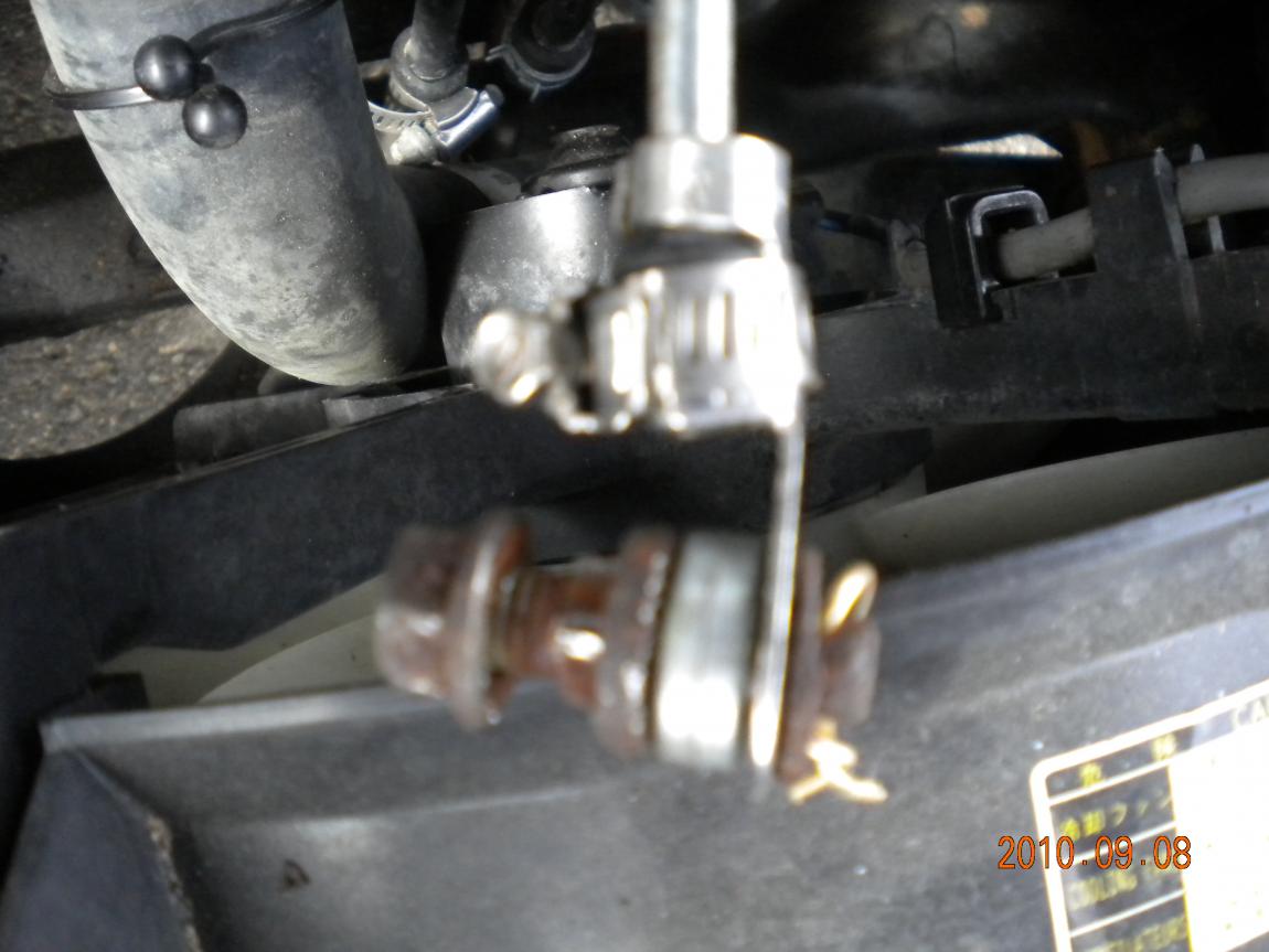

Fix was much easier than I thought. I bought a couple of hose clamps (~$1), found a cable connector that came with a motorcycle battery maintainer and also some kind of plastic wheel that I used as a spacer, not sure where I got that from. The cable end connector is one of those that has an open end that you usually crimp around the bare end of a cable, other end is a loop that just happened to fit perfectly. Took some pictures of the parts and the finished product, but don't have the time right now to figure how to post them (they're too big, about 2Meg each). I could e-mail them to you if interested...
I simply purchased a battery cable clamp (side post style). The hole is is a perfect fit for this shifter pin. I also put a few larger washers in for spacing. Try go get one of the nicer zinc clamps (holds up better than lead). you simply clamp it onto the shift cable (above the ball at the end). Total cost $2.27 at O'Reilly's. Took less than 15 minutes (stronger than the original cable).
I saved a few $$$ with your advice. I have a camry 98 and I was able to save a tow job plus able to fix it within an hour. I grinded the tip of the cable to get rid of the remaining plastic and I used a battery connector (side battery connector) to reconnect the cable. A perfect fit for less than $10.

My wife’s 1998 4 cylinder Camry suddenly suffered an unresponsive shifter in our driveway (luckily for me it wasn’t located elsewhere that would necessitate a tow). I did not know the exact cause at the time until I Googled the symptoms and came up with the diagnosis of a broken transmission shift cable. Having minimal experience fixing cars it took about 10 minutes of looking under the hood to locate the cable and figure out where it connects to the engine. I found the cable severed just above the lever attached to the engine (for those of you like me - looking from the front of the car it is below and to the left of the battery). It seems this is a common area for it to break. I discovered I could manipulate the lever in order to put the car in neutral so I could push it to a more manageable spot in my driveway. [I suppose if you were stuck in traffic with a buddy (or at your mistress’s house) you could have him (or her) move the lever to the appropriate position while you have your foot on the brake so you could put it in drive and get it home to avoid tow charges (or an awkward and potentially more costly situation).]
I investigated the fix to determine if I could handle it myself or suffer another $500 bill at the mechanic (since the car has 135k miles it has been visiting the mechanic frequently). From this forum and others I was confident I could fix it myself. But I didn’t like the fact that an OEM replacement cable costs about $250 locally and $180 (shipped) if bought online. NAPA sold an aftermarket cable for $90 but I learned the following day they were completely sold out nationwide. So I ordered an $80 aftermarket cable on eBay from a seller in Montreal that had a 100% rating. But it would not arrive until four days later so my wife was not too pleased about being without a car until then.
While searching the forums to determine if a V6 cable available from NAPA would be compatible (I never found out for sure but it likely isn’t as evidenced from my further tinkering) I learned the ingenious solution from this thread that got the car running OK within a day and completely fixed within two days (since I have a day job I could only work on it after I came home from work). I learned a little bit more from this situation that might be helpful to others. Unfortunately I didn’t find this thread until the day after I spent a couple hours figuring out how to remove the broken cable and purchasing the replacement online. I suffered through removing the center console, radio panel, two metal and rubber plates affixing the cable to the firewall, and the tough metal brackets fixing the thick parts of the cable to the car’s frame. It was tedious, dirty, and painful since some of the bolts are located in very tight quarters.
I visited O’Reilly Auto Parts to find the more substantial terminal post that screws the cable in place with a bracket. Unfortunately the counter person could not locate the one I wanted and I had to go back home to find it online. When I returned the guy was able to find the Super Start Battery Terminal, part #SK7401 (http://www.oreillyauto.com/site/c/detail/SS01/SK7401.oap?ck=Search_battery+terminals_N0365_-1_3382&keyword=battery+terminals&pt=N0365&ppt=C000 5) for $2.99. I installed it along with a washer in order for the bolt on which it swivels to fit snug.
The terminal post fit quite nicely and it still had clearance to maneuver even with the bulky bolts end. However I learned I’d need to alter the terminal post because it ended up lengthening the cable beyond the normal operating range. Before the alteration my new cable ended up being about 7mm longer than if the original was still attached. This resulted in it being very difficult to put the car into park and being unable to shift to the lowest gear. Not a huge problem because I was still planning on installing the replacement cable when it arrived. But it kind of bugged my wife despite her having her car back within 24 hours. So the next day I disconnected the cable bracket nearest the engine in order to remove my quick fix. The terminal post only allowed the cable end to fit to the edge of the bracket. So I’d need to grind out a groove in order to move the cable closer to hole on the end. Since the terminal post is made of a soft metal (likely a lead alloy) it was very easy to grind the groove with a drill and a file. With that done the cable could now be moved the critical 7mm closer to the business end of the terminal post. Once that was done, I popped it back on the cable and fitted it back to the engine. The Camry now runs better than before (it was previously having problems shifting into drive likely because of the weakening plastic on the cable end) such that I wont even bother putting in the replacement cable when it arrives. Hopefully I can find a buyer for it on Craigslist and cut my losses.
