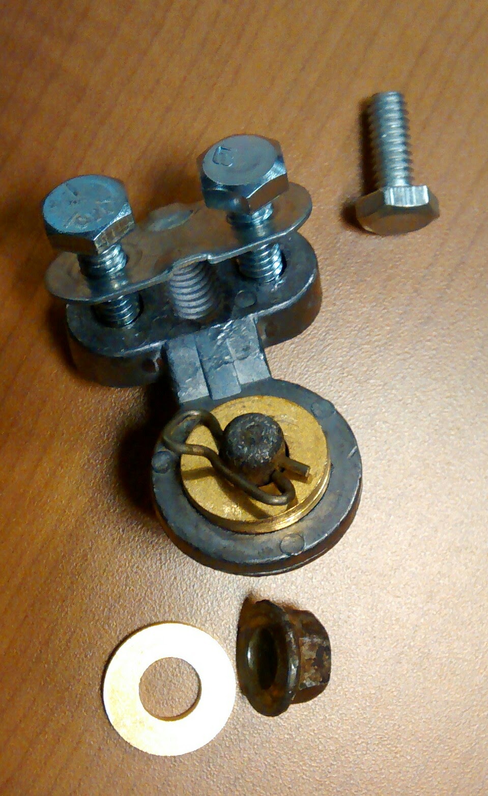

There is a plastic ball that is fused to the end of the metal throttle cable. This ball is usually fine on your existing cable, and is what the battery clamp connects to. There was a cheap plastic clamp on that cable from the factory. That plastic clamp is what fails.

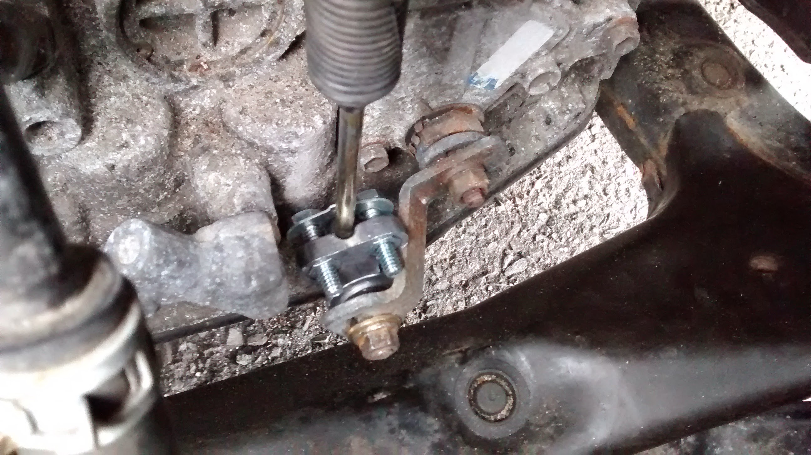

I did the battery connector as mentioned. Works great, the only issue I'm having is getting the gear displays in sync.
They are out of sync by 1 gear, from the console to the dash.
I tried re positioning the clamp on the cable but can't seem to tweak it to where I want it.
Is they another way to fine tune it ? maybe at the console end ?
Old Jan 27, 2016 | 08:32 AM
  #14
davesly@iastate.edu's Avatar
Joined: Jun 2011
You could try looking at some other battery clamps (some may be shorter than the one you purchased). Another option is to move the ball on the cable forward on the clamp, and then use hose clamps to attach the ball to the battery clamp where you want the ball to be (instead of using the battery clamp bolts). Typically, I find that the battery clamps are just a bit longer than needed.

Just bought a Camry and during the test drive that plastic piece on the cable broke. So I bought the car and got the price down a good bit for it. Thank you all for the excellent guide to fixing it! I never thought to just replace that broken part but it makes so much sense. I used the terminal clam and some washers and longer bolts and it worked like a charm. The hardest part was removing the old rusty bolt. Thanks everyone!

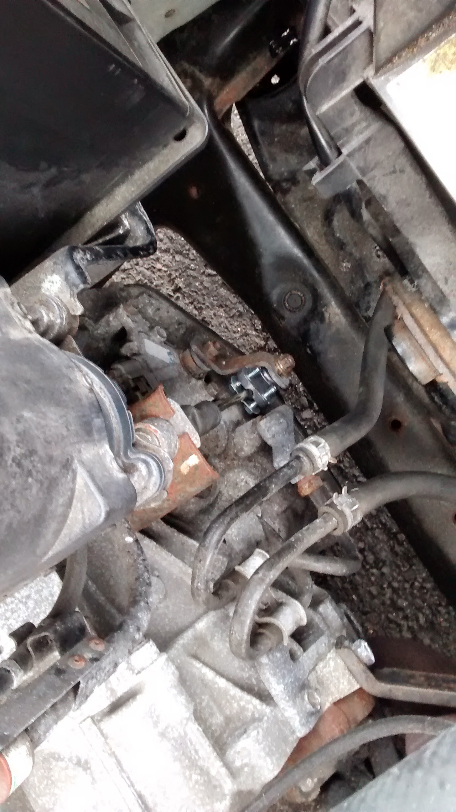

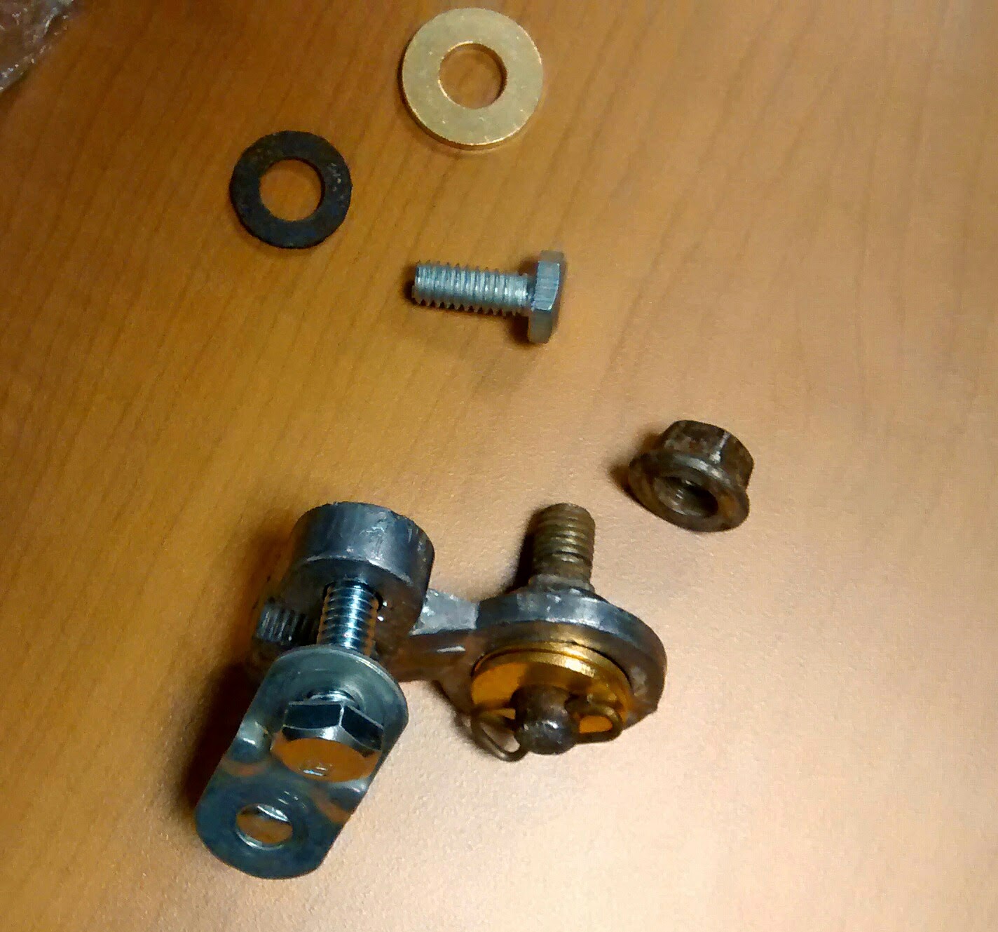

Used this Battery terminal Advance Autoparts AutoCraft Side Post Battery Terminal
Attached Thumbnails 97 Trans Cable replacement-_20150327_103220.jpg   97 Trans Cable replacement-_20150327_103247.jpg   97 Trans Cable replacement-img_20150327_173244060.jpg   97 Trans Cable replacement-img_20150327_173250010.jpg   97 Trans Cable replacement-img_20150327_173255067.jpg
