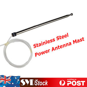

on most newer motorized antennas its metal extendable part is normally attached to a plastic ratchet
pulling the metal part up with force may strip the ratchet
called a mast and rope
looks like you will need to reach the motor and with a volt meter see if it has power and a good earth
or the problem is at the black radio wire connections
a diy guide how to fix a stuck antenna
http://www.familyhandyman.com/automo...tenna/view-all

The antenna has a plastic coiled rod that moves it up and down. This rod can break. Replacement antenna's with the rod are available.

i listened to my car and when i shut off the car i hear the antenna motor? in the rear of the car so i think it is hooked up. where do i get the replacement mast or plastic tape?

that is good news
buy one off
ebay
general all types automotive parts and supply shops
toyota parts division
youtube has some instructional videos how to replace a mast and ratchet part
