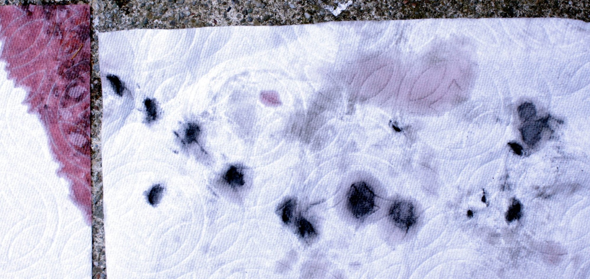

Follow up: after 332 miles, I drained and changed the differential fluid. As shown above, the fluid was off-pink. On the drain plug was about 1 ml of a dark muddy substance. There was metal shavings at the base of the drain plug, not not on top of the magnet. However, they might have been from the last drain, because I don't think that I removed them.
Your thoughts about the condition of the differential?

The concern of course is the metal debris.
The diff has a removable cover (finned cover with fill port). It may be possible to remove this cover in car and inspect the diff.
Could try flushing out the differential only (NOT trans!) with kerosene. Remove both fill and drain plug. Pour it in using a long nosed funnel and see what debris comes out the bottom.
The trans fluid will last a long time. The issue is the metal debris.
