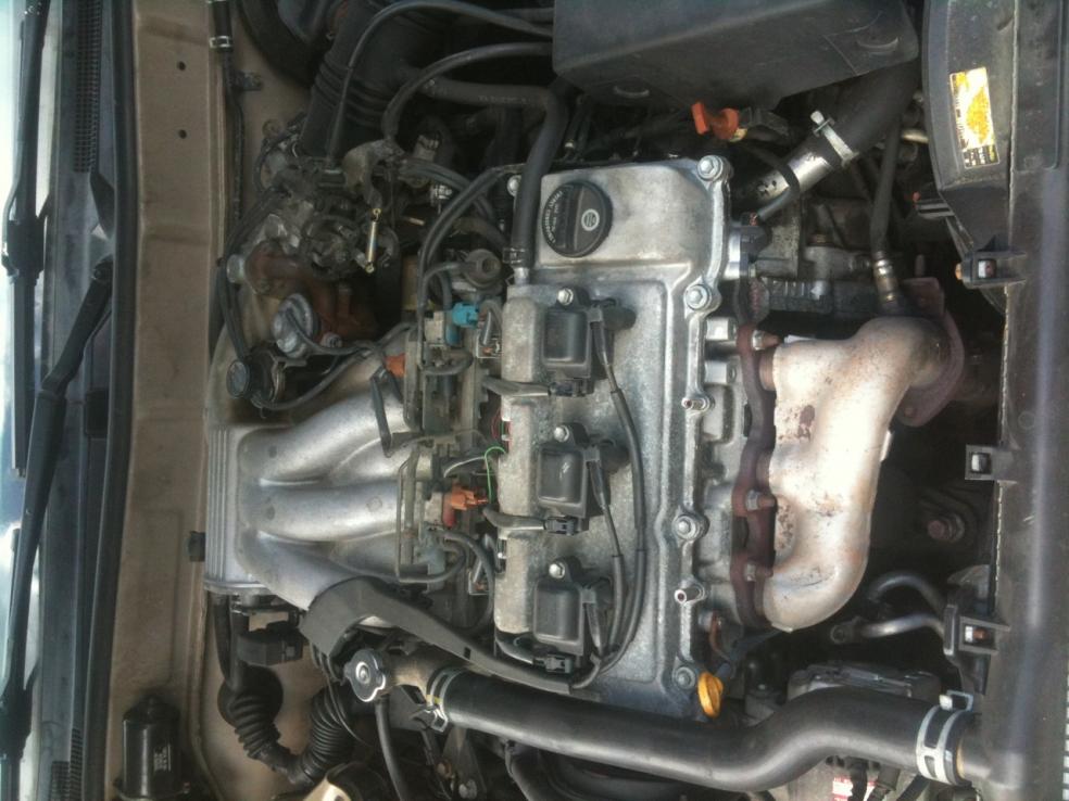

On the Hanes repair manual for the 3.0 V6 on my 96 Camry it shows 3 VSV on top of engine is this correct? 2 on one side facing front of car and 1 facing towards the driver but all on top like in the pictures provided..how to clean them? if soaking with what? I know a local Jiffy lube type place that do a Sea foam based Full throttle body/EGR pressure cleaning should I bother?
atleast by picture, I would say your egr VSV looks like blue one... Also you can bypass the metal tubing line clog suspect by just running straight vac rubber lines from VSV to egr and modulator. Get vac lines from pepboy, its cheap.

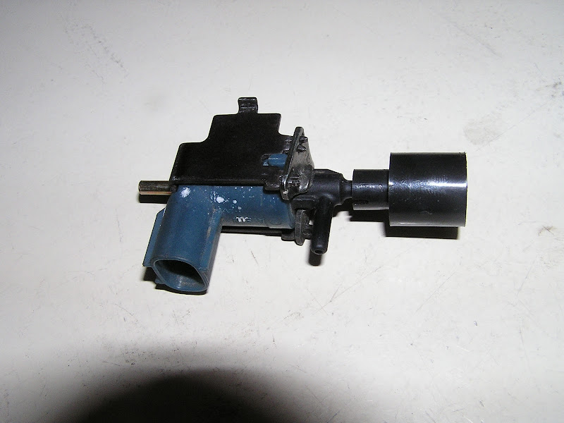

there is only one VSV for egr for both [4cyl and 6cyl].. that VSV has one vac line connection going to EGR and other one going to vaccumm modulator. On my 4 cyclinder engine its blue color and there is part ##,,, pics below.

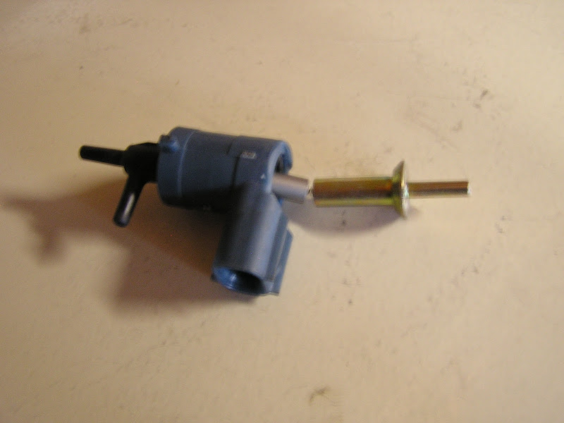

clean the VSV.. It all comes out pretty easy. just unplug vac rubber lines, take end muffler cap off by twisting if off. and take metal housing off by channel lock pressing the prongs together, take cap off and other metal housing off.
On my car,,, the brass piping part was the one that was clogged up with carbon deposit..I just cleaned it a tiny drill bit by hand, also can use carbs cleaner.. I suspect for most people this part is the one that gets clogged up.. I think for most part, electronics are okay, just clogged up.
Once I cleaned it up and put it back in car,,,everything worked great, light went out.
I would suggest to leave check engine lite on, don't reset it and after cleaning VSV... take a drive and see if it turns off by itself... Usually check engine lite needs 5 seqence of error for lite to come on,,,meaning 5 times of driving, turn off and drive again,,, high speed frwy driving..Atleast that's what I read and believe so by my experience.
take brass pipe part off by hand if possible, if not then get pliers and twist it off, there is a small spring and another little metal cap part inside, will come off if turned over.
See if the brass piping part is blocked with carbon by blowing, if clean should feel air on end, if not then its plugged up.. But really just get a small drill bit or whatever and stick it inside to clean it out...but drill bit worked for me, twist drill bit by hand and the carbon just fell off or clean with carb cleaner would be okay...
Also make sure 2 plastic pipe hole is clean by sticking in something small like a small allen key. Also you should be able to see hole throught the housing by looking through the hole where brass pipe came off from.
Pics explain best...not to good with words.
Just don't loose the small spring which goes in brass pipe and other small metal spacer looking thing..
