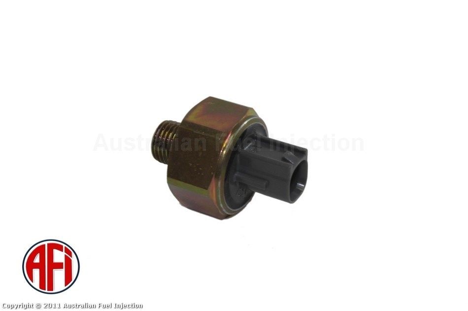

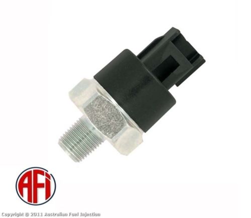

a 1995 4 cyl has a knock sensor
in a 1990 4 cyl camry repair manual (gregories)same spot says and oil pressure sender
if you can't tell after yours has been in a fire
to really know ....undo that sensor... and go to part identification
oil pressure sender has a tapered thread.......... a knock a straight cut thread

Confirmed,
It is an Oil pressure Sender/switch
