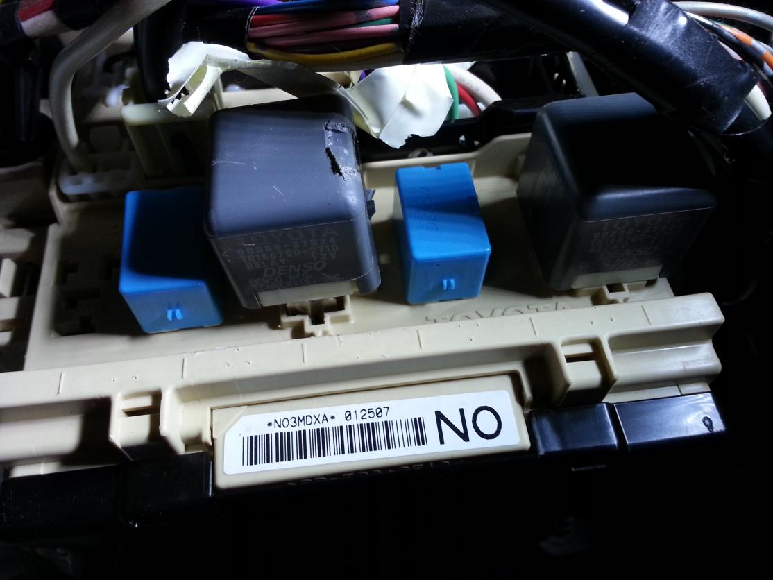

is this relay gray square or blue rectangle?Accessories wont cut off...-20140313_225934.jpg

is this relay gray square or blue rectangle?Attachment 3122

so i changed the 2 blue relays and problem still persists.

The ACC would be the larger sized gray one having the scuff mark on top. The one between the two smaller blue ones.
Remove the relay and determine if the items now turn off.

i removed the gray relay and swapped it with the gray relay from the far left and still acc stay on.

Remove the relay, don't swap it. Determine if clock and radio off.
If now off, replace relay and determine if now on. If so, remove AM1 fuse and determine if now off.

i removed ecu acc1 fuse from fuse panel and that cut off the clock. i removed the gray relays and nothing changed. acc still on without key in
