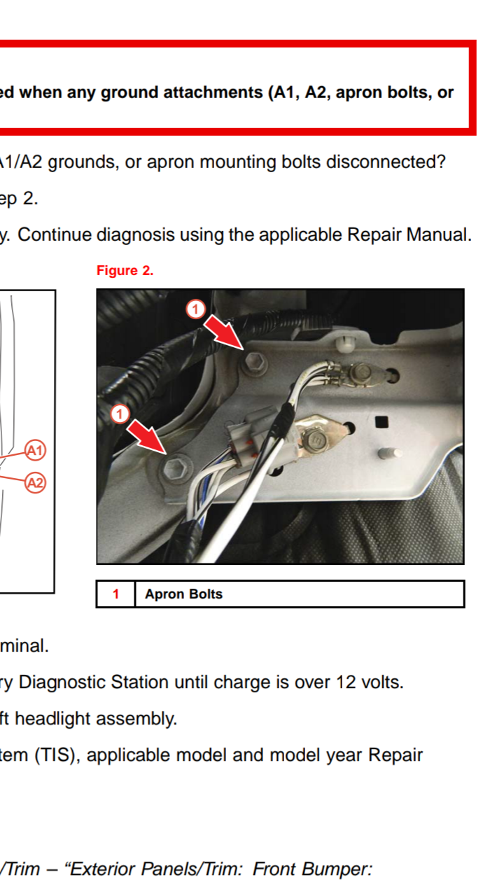

When installing said replacement make sure the unit is grounded properly per the bulletin below.
http://www.crrtraining.com/CRR2/asse...echinfo_14.pdf
