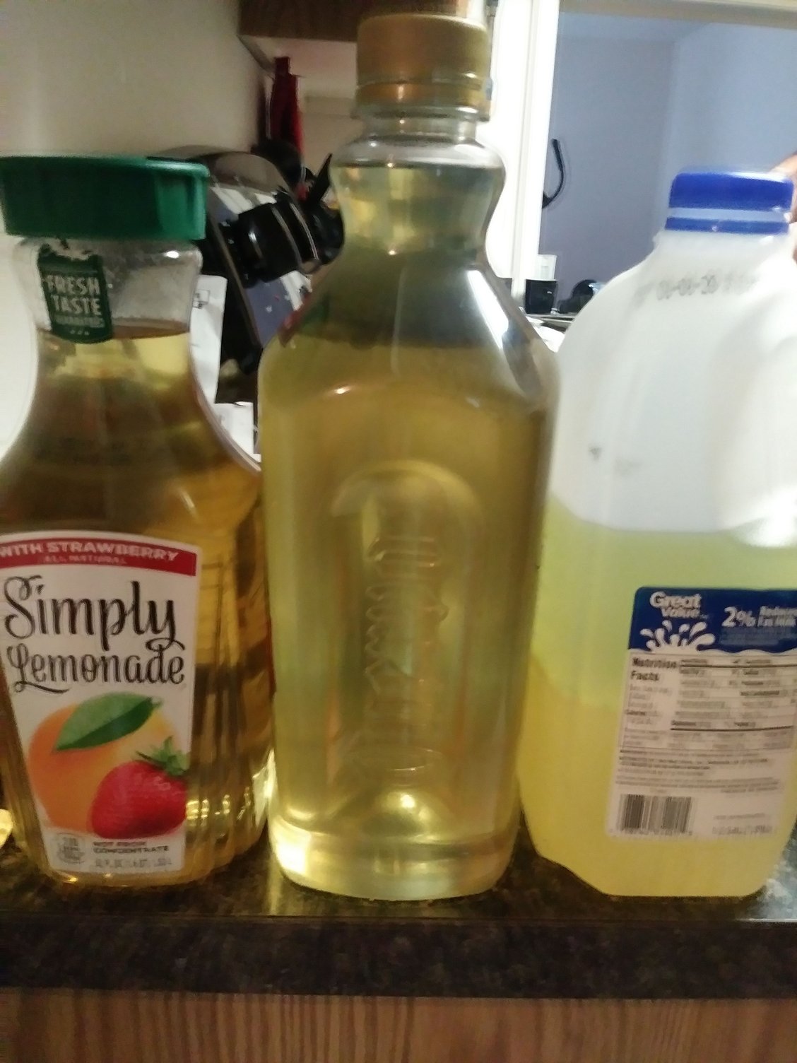

Posts: 6
This contamination was in my fuel tank. You can see the separation in the right jug. Top layer is gas and bottom layer looks like vegetable oil or water.

I put in a new fuel pump and filter sleeve as well. I soaked my fuel injectors and 91% isopropyl alcohol, put them back in the car and try cranking it over and still the engine would not fire. If I'm getting proper fuel pressure and Spark, why is the engine not firing over? Is it my computer?

Are you now getting clean fuel at the fuel line disconnect in engine compartment?
You sure the injectors are now unplugged?
Make sure the crank/cam sensors are hooked up.
