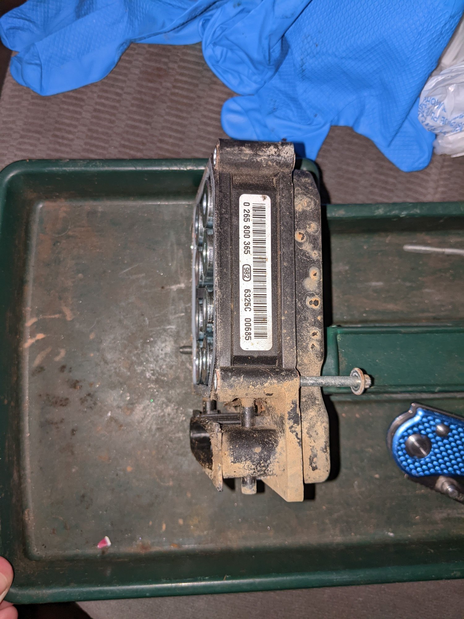

When I jumped the pins, the ABS light stayed on, continuously solid. No blink code. I surmised and later confirmed online this meant my ABS model was likely not functioning correctly. At the very least, the ABS control module was dead or malfunctioning, and possibly more. The modules can be found on eBay but are kind of expensive. I went to a local car junkyard and purchased two for $20 each(in case one was dead). The ABS module is located in the front passenger side of the engine bay. It is secured with four 4mm bolts and has one connector that must be disconnected before removal. It took me less than five minutes to remove it. I haven't found torque specs for the bolts, but since it appears the module is secured to plastic, avoid overtightening but make sure it's snug and secure. This instantly solved my problem. The speedometer began working, the ABS and Brake light turned off, and the check engine light didn't return(after I cleared the code). Surprisingly enough, it also solved my rough idle issue which I had assumed was unrelated.
Hopefully, someone else finds this information useful. I learned all of this through research on this forum and others, as well as my own trial and error. I've attached pictures of the ABS module and where it's located in the engine bay.
