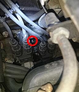

The oil seems to be leaking onto the engine block under where the red circle is.
The image is not of my car, but it looks almost the same. I'll post a better one tomorrow when it's bright enough to get a good picture. I know it's not in the valve or the gasket as those have been replaced and that the damage was done before I got the car when this engine was put in. The mechanic dropped the engine somehow, presumably while installing it.

The hole that is circled in red is leaking oil like Niagra Falls. I did the UV trick, and that's where it's all coming from. I have no idea what that hole does or why it's there. Could it be the oil gauge? Because I've run out of oil before and the oil light on the dash never comes on. I would think that if you were down to a quart it would be on, but I'm not a mechanic so what do I know?
The picture is taken from the point of view of the right side of the car. It's a close up of where I had circled in the original picture in my first post.

You going to have to remove the bracket holding the ign coils to view the engine and source of the leak.
The leak could be from the valve cover. Or from a half round plug that fills a hole in the engine block. This hole is were the lower half of the distributor installed in prior year engines.

I had the valve and the valve gasket replaced, as the valve had other issues. So, I don't think it's that. What is the half round plug? Is there an "official" name for it?
Old Aug 25, 2018 | 09:50 PM
Semi–circular plug, looks like a half moon. It fills a spot in the wall of the head.
https://www.ebay.com/p/Engine-Semi-C...6570/110182924
The bracket is in front of the engine and appears to be hiding the leak.
