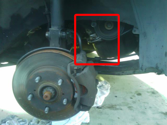

Alright so today i did some more work and based off that picture if you can see it.
It seemed the areas with most oil was the CRANKSHAFT, the OIL PULLEY, and the GUIDE PULLEY.
Now also behind the engine where the valve cover is its leaking oil i assume this is due to an old valve cover gasket.
So if its the CRANKSHAFT, the OIL PULLEY, and the GUIDE PULLEY should i just buy the replacement rings/gaskets?

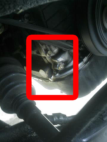

Ok so after i finished cleaning everything. I finally decided to turn on my car and what do you know, it was clean and dry before but after i turned off the car, there is a trail running along the crankshaft. What does this mean?
Old Feb 17, 2011 | 08:43 PM
The oil pump, driven by the timing belt and is located above the area identified. A good indication of a leaking oil pump seal is the oil starts to drip in the area identified when the engine is running. The seal is under oil pump pressure at this time.
The crank and cam seals can leak but the oil is not under pressure, the result can be more seepage then a steady leak.
The seals are the cam, crank and oil pump. The guide pulleys are sealed bearings.
You will need to remove the timing belt cover, once off inspecting the above seals will determine which are leaking.
The cam, cranks and oil pump seals should be available from a auto parts store or the dealer but may need to be ordered.
To replace the oil pump seal the pump needs to be removed from the engine and taken apart (or replace the pump). There is a preformed O-ring between the pump and the engine this may be a dealer only part, replace this O-ring.
If it is the oil pump seal and your keeping the car might replace the cam and crank seal at the same time. Also check when the timing belt was last replaced.
