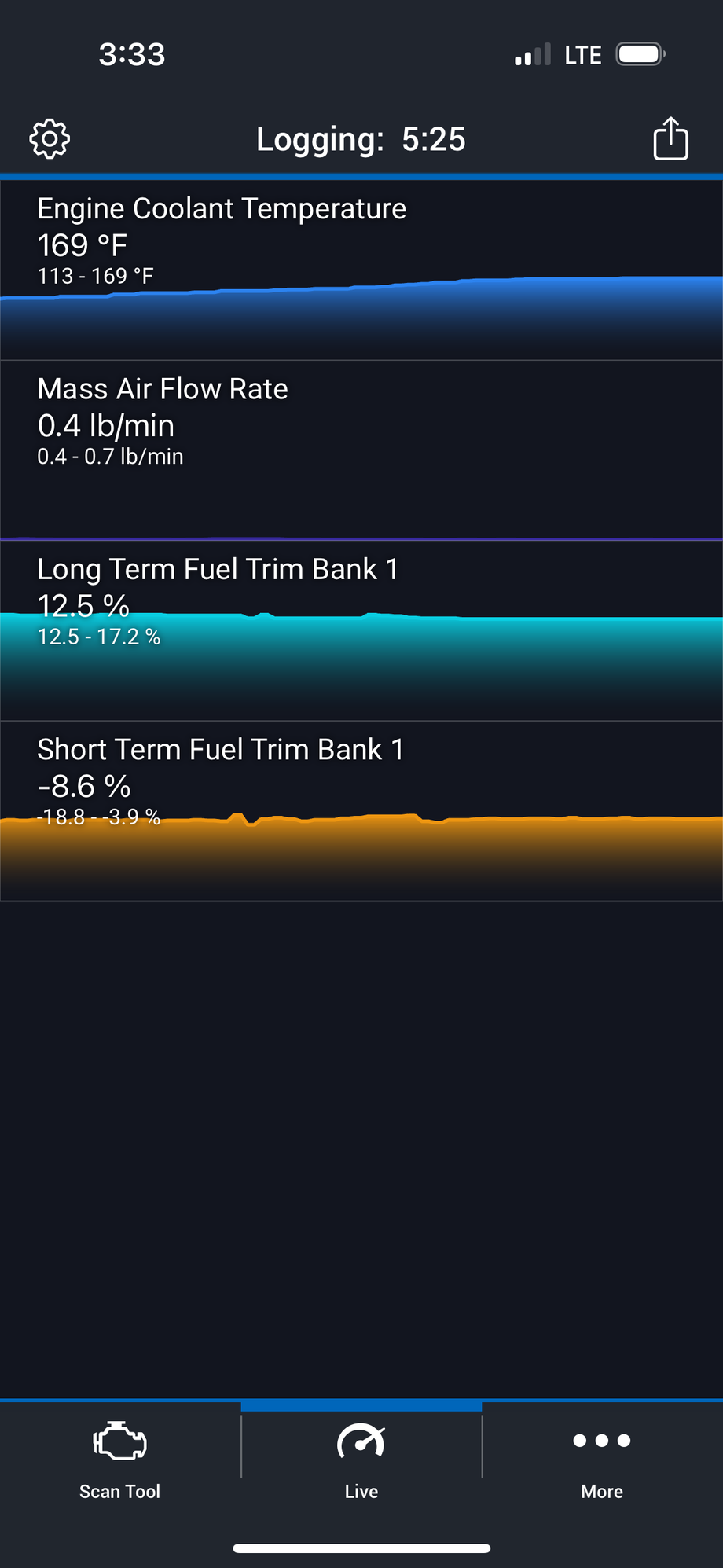

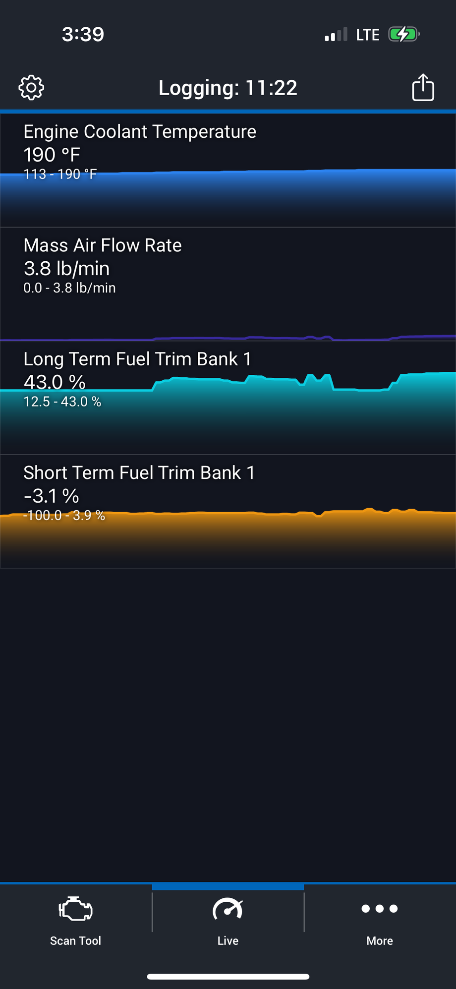

Super high long term fuel trim….
Gets way worse under load…
Any ideas?
(mechanic thought it was downstream O2. Replaced it. No help.)

the trim is about 10% when first started up, but increases fast with any kind of rpm.
