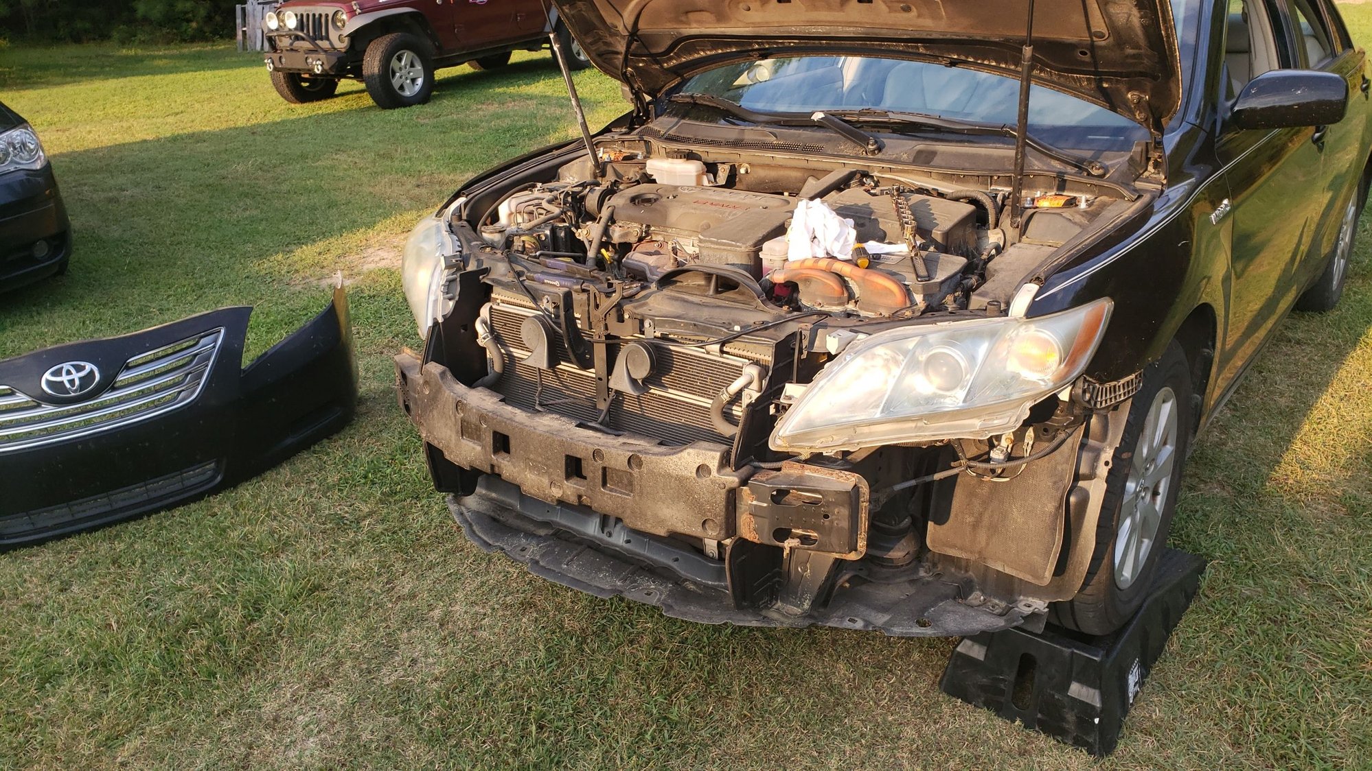

I have bought (and returned) all of the headlights assemblies I could possibly find.
I found that all of the Camry headlight assemblies fit every single Camry US or Japan built, Hybrid or not.
I did confirm that hybrid headlight housings only differ, in that they have the blue tint inside the house.
The only other thing to note is that some housings came with a little extra material at the bottom of the housing to mount an HID ballast.
This extra material did not interfere with installation at all.
Old on the right New on the left. Decided to go with a black tint to match the car. The tint doesn't affect light pattern of high or low beams
I am very pleased with the outcome. The low beams are more crisps. The cut off is properly alligned and doesn't glare into on coming traffic.
She feels like a new car now. Thigh beams are twice as wide and cover the all gaps that the low beams miss. I love it.
A simple cleaning of the old headlights would not have been sufficient for me.
I do hope this helps others.
