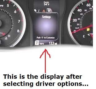

30,000 miles on my 2017 LE but now the cluster “multifunction” display has problems. On start up, it appears that the cluster display / electronics are booting up OK – but once in drive and moving down the road, there is only a “snow ball” display in the center of the cluster.
I can select various settings (miles to empty, speed, etc.) – BUT nothing is saved or displayed.
The push button switch on the left center of steering wheel selects and displays various options and appears to interact with the driver BUT no changes are saved.

Don't know.
For steering wheel switches search the parts catalog at an online Toyota dealer for "steering wheel paddle switch".
84610-12130 is right side or 84610-12120 is left.
The switches are off or on. Would assume the save feature is part of the display circuit or whatever computer it is connected to, if any.
You could diagnosis the switches operation to determine if the are working on/off and not sticking on.
These displays can be a pragmatic. Suggest you go to the Toyotanation.com site which has a discussion on this. There is some info about bad circuit board solder joints.
If you think it is the display, Ebay would sell used instrument clusters as Toyota doesn't appear to . Perhaps the display could be swapped out. Or if you handy with electronics check for cold solder joints.
