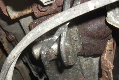

I can't get a good clutch pedal and I have been bleeding the slave cylinder several times and the pedal is hard but still drops to the floor. I was looking around and saw some fluid dripping underneath where those 2 lines are connected to on the trans. I pumped the clutch pedal again and I held the pedal with a pry bar and saw the fluid coming out underneath.

its the accumulator .... has a gasket under neath it //look at that first

Where exactly is the whole clutch accumulator assembly located? Hows does it come off? Is it just the block where the slave and clutch master cylinder lines connects to? And to remove it, disconnect the lines and its bolted on a plate on the transmission?

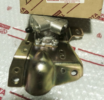

Using your pictures and
the part picture (says its correct part for 1992-1997 toyota camry )
Toyota Camry 1992-1997
Accumulator Assy Clutch
Toyota Genuine Part part number- CA01305B
and your vehicle is the 97 Camry v6.
I am interested to what you find there
because the repair manual suggest no moving parts
yet you have a leak
another throw away part maybe
that bleeder suggests to me a diaphragm valve so something not serviceable
your picture
undo the brake lines
that big rusted plate bit can be undone .first . looks like held on by. a few bolts
when the plate is clear the screws holding the accumulator can be undone from the back .
. you might be able to sort some thing out
clean up and paint the rusty plate
fit or make a gasket .....and hopefully save some big dollars

I called the Toyota dealer and the part number they gave me is 3149033021 and the price is $112
