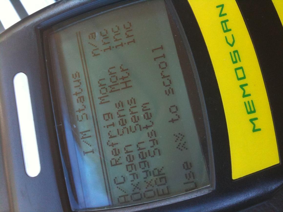

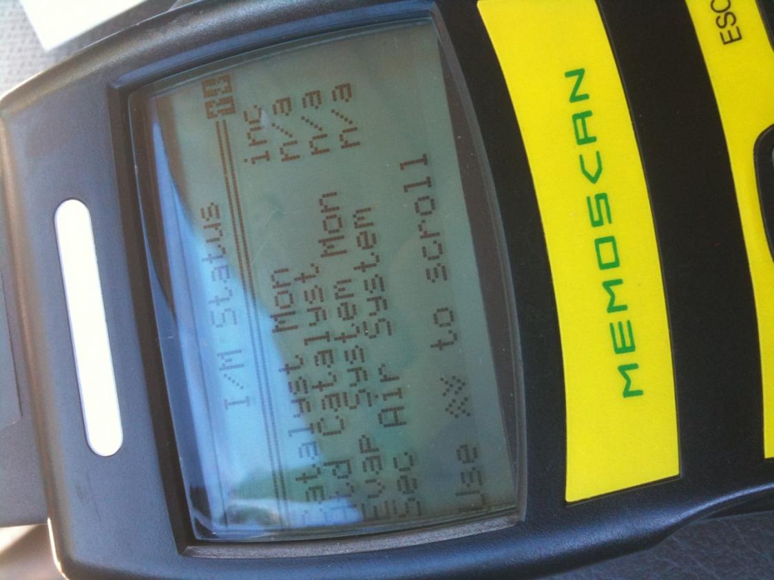

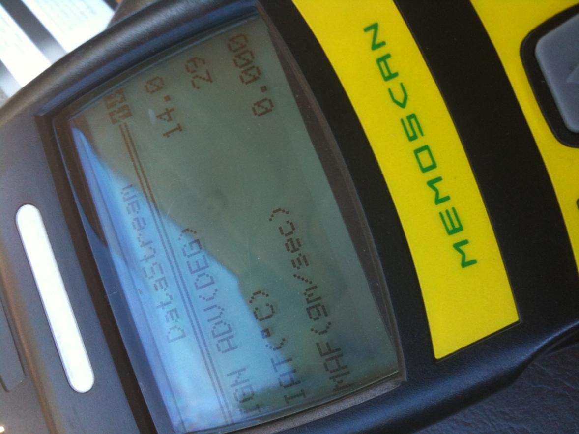

Ok I replaced VSV with another same part number..tested it and when powered it won't permit air to pass anyways I reset light and it came back...I had applied vacuum to EGR and engine started running rough which by what I understand signifies the system through the EGR is clear..now let me say I bought car with engine replaced with another identical engine from Japan so EGR system had to be installed on this engine..asking the previous owner the car had no engine light for about 6 months after engine was replaced anyways I'm wondering if maybe some sensor or something was missed..here are some obdii scanner pics if anyone can figure anything that may help please advise.

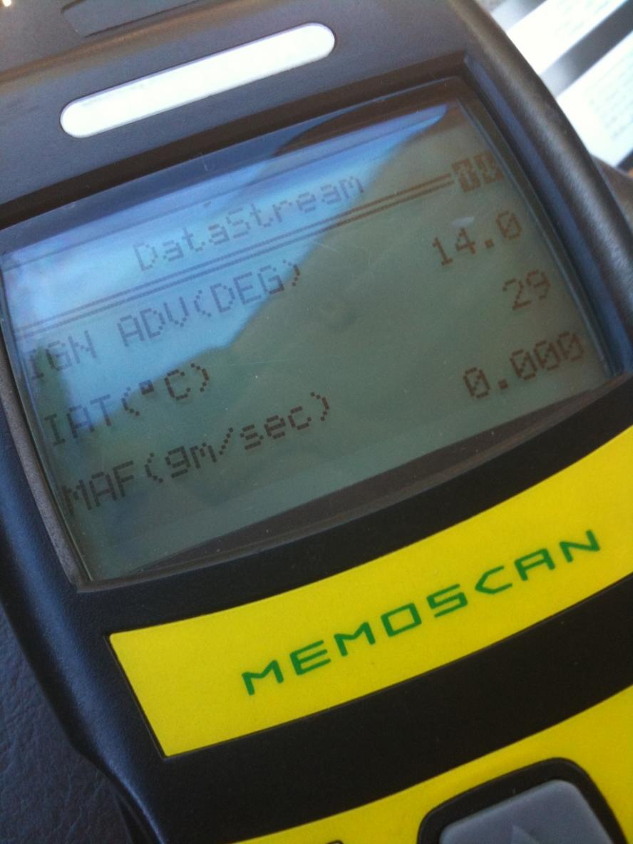

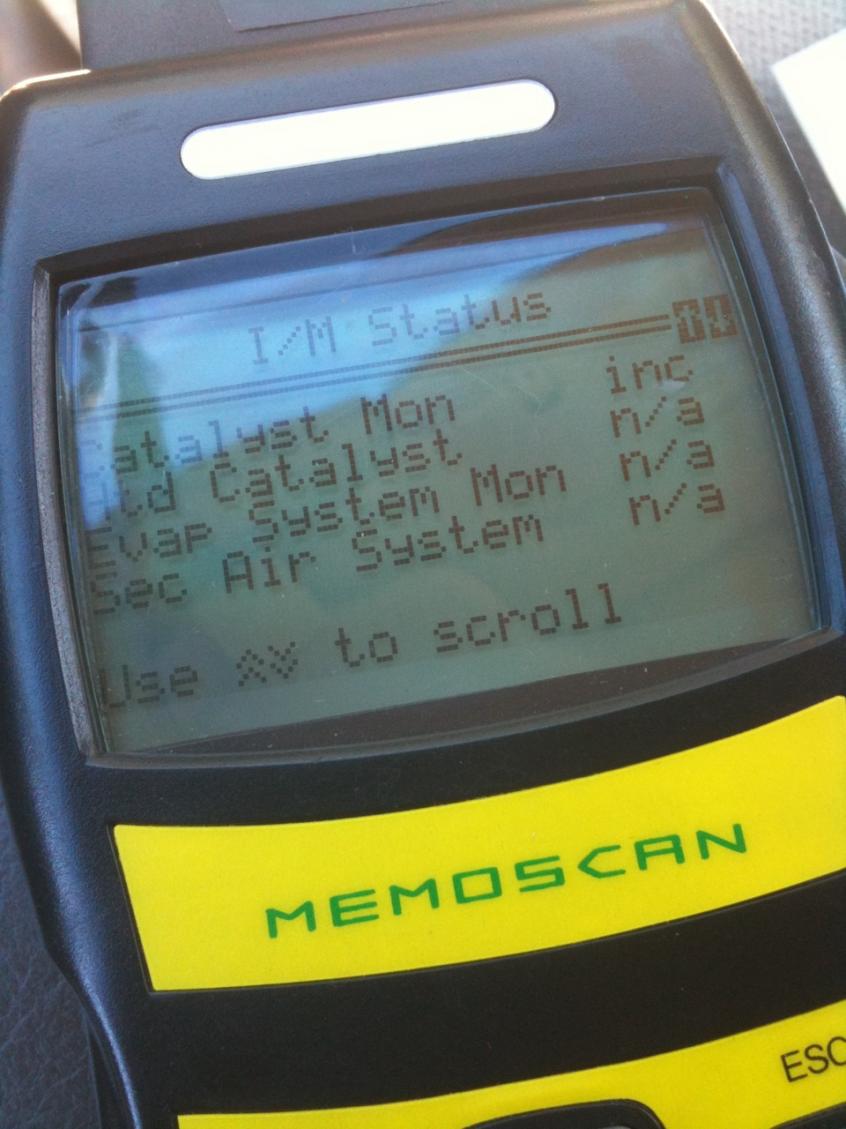

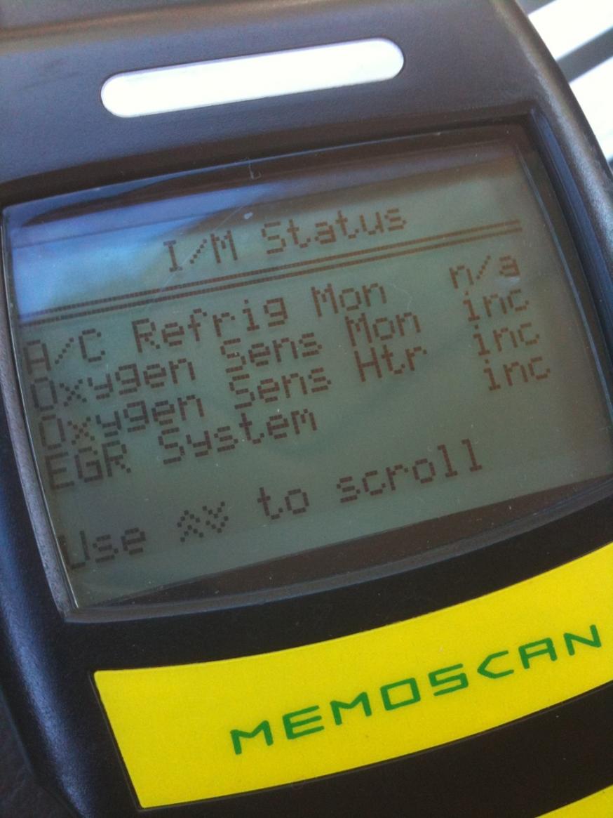

Sorry here are pictures straight.

Old Sep 28, 2010 | 07:40 PM
  #35
Posts: 15,178
The computer does not monitor every sensor.
Was the CEL on when you purchased the car?
Sometimes Japan engine emissions systems are different then US.
Have you reviewed how the EGR system works? The link below has some info on this. Your system may or may not have an exhaust temp sensor on the EGR valve.
http://www.autoshop101.com/forms/h61.pdf
