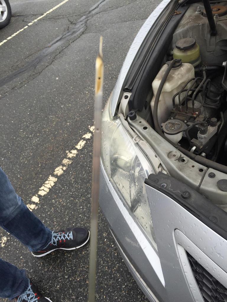

Unbelievable !
So my daughter drives the 1,200 miles for the consumption test and I ask her to check the oil and take a picture before she brings it back and it's low as expected. The service rep calls me and said his Tech checked and everything is fine. I tell him that it's low and we have a picture and he says that's because we should check it while the engine is running... true story. So after arguing with the guy I tell my daughter to leave and I check the oil and it's a quart over full after the car sat not running for 2 hours. So it's pretty obvious to me that they just added oil back in and they are trying to run the clock out.

When she took the car in initially they changed out the oil even though I had just had it changed about 300 miles ago at express lube. I actually believe that when the Toyota dealer changed the oil, they added an extra quart because I would have expected the level to be much lower than what my daughter's reading showed. Now the level is at least a quart over again. I think that you're right about when they see a 20 year old girl or any woman, they try to take advantage so I am going to have to do this myself which is a royal pain since my daughter lives about a 1/2 hour away and has a crazy schedule with school and work.
So, prior to the start of the official Toyota oil consumption test the dealer changed the oil and added an extra quart?
The dealer may have wanted to change to the official Toyota recommended weight of oil but overfilling the engine is of course underhanded and not per the service bulletin directions.
That is why suggesting doing your own test. There is no sense getting into this issue now if the engine is not using more then 1 quart per 1200 miles.
Suggest you educate your daughter as to how to use the dipstick to measure the engine oil. Also given the engine burns a lot of oil, you don't want the engine to run low on oil between oil changes. One quart low is OK, 3 quarts as has happened to owners due to excessive oil usage is not OK.
If my kid and car, would have them over and I would change the oil myself. Then when refilling, mark the dipstick with an engraving tool each time I added a quart of oil or maybe 1/2 quart as the dipstick measurement may not be linear with how much oil is in the engine. Do this until the engine was full. When adding oil making sure it had time to drain from the head to the oil pan. Ditto when checking oil level during the test.
Then the driver can see for themselves if the oil level is dropping and how much and record this plus odometer reading in a logbook. Use the same weight as recommended by Toyota for the climate temp. If the oil ever got too low, of course add more oil, but one quart low is well with in safe parameters. Then you will know what consumption the engine has now and a have base line for the future.
Yes, a pain in butt to deal with but if the engine does have excessive oil consumption, either now or in the future prior to the extended warranty expiring, Toyota should be able to be forced to repair it. This issue has been going on for years and I assume hundreds if not thousands of car owners were told by Toyota to just deal with it as they would do nothing to help. That's why the class action lawsuit happened. This engine has known major problems (the oil consumption being just one).

All good stuff here. I would add a few things.
The filter used will have an effect on how much oil it takes to bring the mark up to the F line. If the filter is placed on dry, you have to crank the engine to allow oil to fill the filter - meaning the level on the dipstick will change between a look before you crank and after. Take a look at a Toyota OEM filter compared next to say a Royal Purple filter. The RP is very much smaller, so holds less oil in it. When I put in a RP filter on my Camry I put in about the same amount of oil I always do (actually added .5 quart extra by accident), but that time the dipstick read a fair amount over the F line. I figured it out as less oil in the filter meant more in the pan, plus my extra .5 quart.
I like toyomoho's thinking on engraving the dipstick. Excellent thing to do on an oil change. Drain that bad boy dry, then check the dipstick to make sure there is no reading on it. Put in exactly 1 quart and wait several minutes to allow the oil to matriculate down to the pan. Mark the stick. Repeat. Generally speaking this should give you an excellent idea of exactly how much to add when you drain and change the filter. Plus, you can overfill by .5 quart and mark it to see how much higher it goes on overfill.
Those lube places are dangerous in my opinion. Way better to change your own oil. Autozone and other places like it take your old oil for free. I have had those lube joints leave tools in my engine compartment, and no telling how much they actually put in. Our Camry's don't exceed the 5 quart deal they have, but I have heard stories about Tundra and other trucks that those places try to state they had to put in 6+ quarts (up charge) when the manual states otherwise.
How certain are you they put in 1 quart extra? I don't think there is a linear way to measure off the dipstick, due to the shape of the pan, etc. If you engraved the stick with an extra .5 then 1 quart on an OCI you would have a fairly good mark to measure against going forward.
It doesn't surprise me they did an oil change. They need to make sure it is OEM oil at the proper spec and (theoretically) the exact proper amount. That is why I am wondering how you gauged 1 quart over, as if they did that they are being shady big time. That is letter writing time to the manager, copying in Toyota central.

Both my daughters know all too well how to check the oil and add because they don't live with me and they have been doing it every 2 weeks for the last 4 years. I am going to see how long it goes now before having to add again. After looking at what's involved with the repair, I still have reservations about letting any dealership do all that. There is no equivalent to a factory assemble engine imo. The down side now is that all of this will show on a carfax should I decide to sell. I may call Toyota America and speak to them too.
Still suggest doing your own oil consumption test and dip stick calibration. You need to know yourself what the oil consumption is or the dealer is always going to have the last word.
