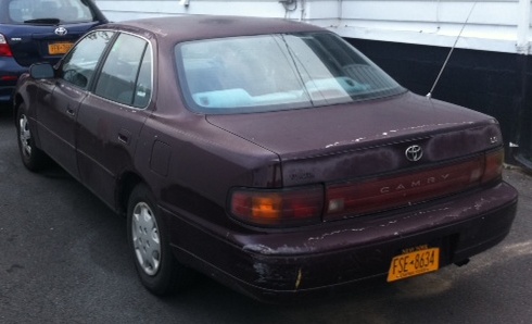

Hello I was just wondering if anyone else knew about this problem I have with my 1992 Camry LE.
When I turn my lights on, they dont go on, but if I sorta whack the stalk a bit they pop on.
However, when I put my blinker on they turn back off again.
Also, when I push in my cruise button to turn it on, the green CRUISE light comes on for a little and then when I go to set the speed it turns off.
what the heck is going on here..
Do I need something in the steering column fixed or what?
Thank you!
