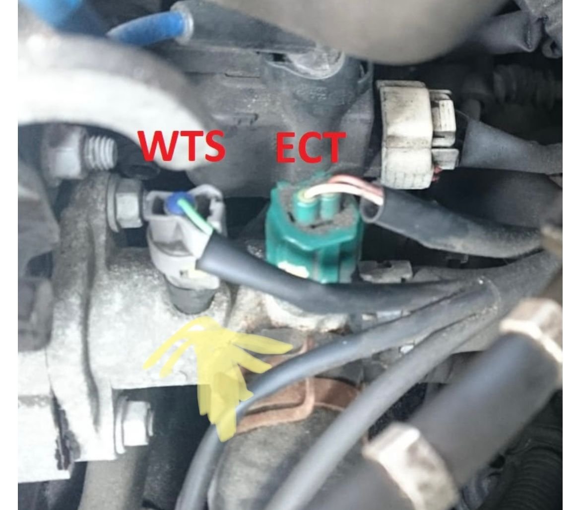

99 camry previous owner replaced engine
2.2 engine after driving and car gets warm it stumbles dies and p0120 code pops up and car won’t run and idle unless tps is unplugged (tps is new) all sensors have been replaced with all oem sensors and now I inadvertently broke a wire on what looks like one of the coolant temp sensors (the sensor with one wire) not sure if name but one sensor has 2 wires the other has 1 which broke and now p0115 now sets .. please point me in right direction where to start and if more info is need I’ll explain best as I can
