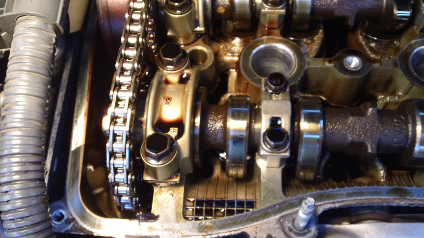

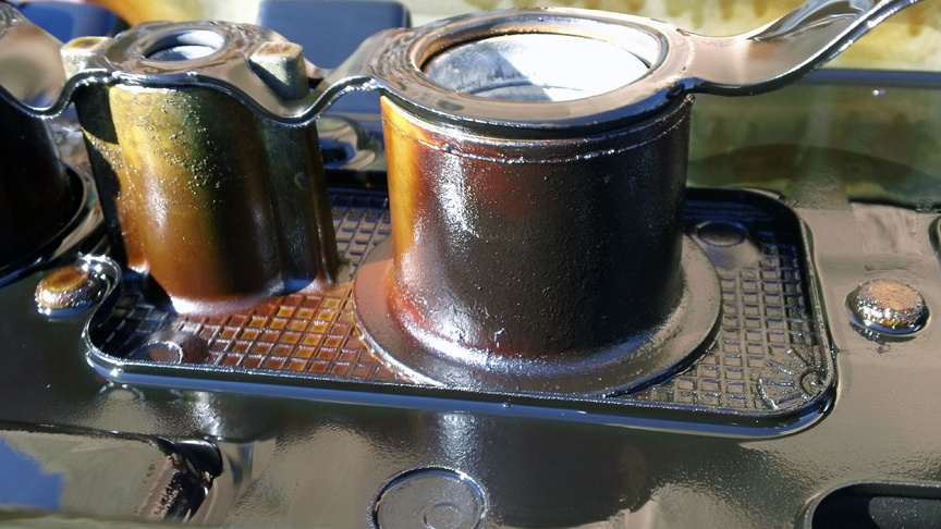

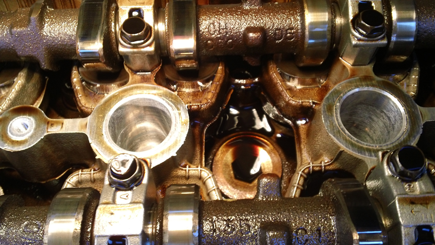

OK, scoped the tops of the pistons and took a look inside the valve cover today, then set in a Kreen soak. Tomorrow I will blow out the Kreen from the cylinders, then scope the piston heads again to see what effect it had. Then I will put about .5 quart into the oil and a pint into the gas tank and run it for 500 miles or more, then open it all back up and see what we see.

Very cool! I'm really looking forward to how this comes out. Thanks so much for keeping us all informed!
Can't wait for the results!

Because one of the ignition coil wire ends broke, I am on ice on it until the repair kit comes in later this week. But I did crank over the cylinders this morning to blow out solvent, which I think had just soaked right out of the cylinder (I did not put much as the can called for 1 oz only). I scoped them again this morning and they look the same to me. I'll process video tonight after work and get a better look, but I think the real money will be after the oil add (putting the Kreen in the oil). Not really important to me what the tops of the pistons are, as long as the rings get de-crudded.
Sadly my borescope does not seen to be able to bend enough to get great views inside there, and the angle attachment is sort of sucky, but I'll try it again later

Ran for a little over 400 miles with a bit over half quart of Kreen in oil, rest in gas. The can calls for a full quart to run for about 30 minutes then do an oil change, so I changed the oil, put in a full quart to abot 3 quarts oil, and drove to a family function (about an hour drive). Drained and refilled with Mobil1 0-20. I scoped cylinder 3 and saw shiny metal on some places . I did not dump as much Kreen in the gas as was called for, but think I will buy more. I'll post the video later. Tomorrow, if I am not snowed out, I will lift the valve cover to see if there is any notable difference after this oil experiment.

Cylinder 3 after some Kreen treatment. Not as much as was specified should be placed in gas tank, so will buy more and put in the pint per 5 gallons as recommended, run a full tank down, then scope again. 400 miles of .5 quart Kreen in oil, drain/refill, 1 quart Kreen in oil for 50 miles, drain/refill.

It seems hard to see a lot of difference from here so far.

Thanks, and yeah, not much de-carbonizing that is apparent. But, I did not put in the full amount specified (in the gas tank) and there are a lot of miles on it, so would have been something to see a big difference on the top of the piston. I am more interested in the oil run, as I exceeded the can spec for that. I am very interested in watching for any drop in oil consumption or any bumps in mpg. Theoretically my rings are now in better shape so we will see. If it wasn't for the fact it was 14 degrees F this morning, snowing, with howling winds (going to be that way for some time now the weather folks say) I would take that valve cover off and look for any visible differences there. But that will have to wait for the weather to accommodate me!
