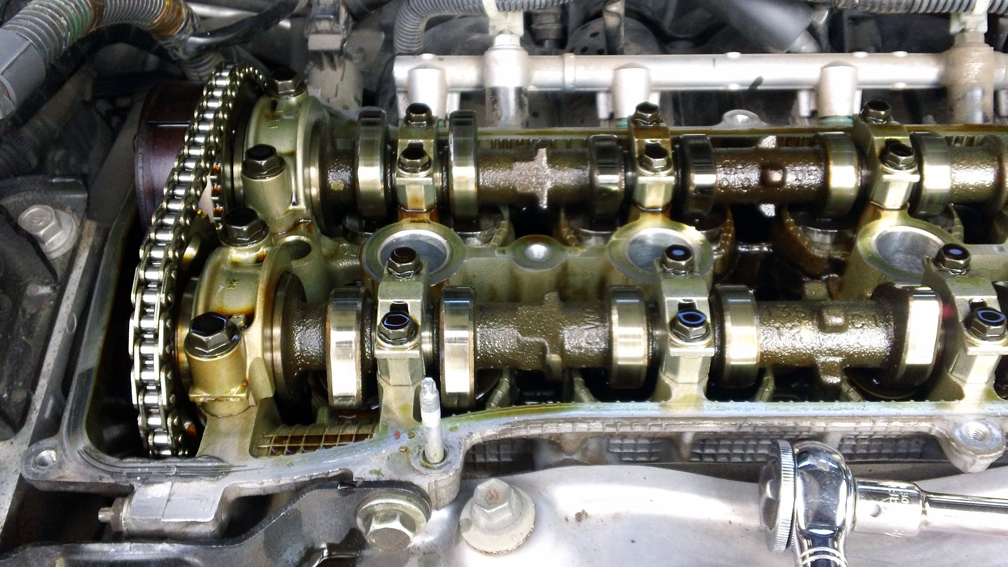

Finished up my half tank run with 1 quart of Kreen in the tank. Can't say I notice any real difference on the top of the piston head. Below is #3 again, after running about 6 gallons of gas through the engine (1 quart to 10 gallons gas as per the can instructions. My warning light goes off with about 4 gallons in the tank remaining).
https://www.youtube.com/watch?v=RtXuipUj3sc
Also lifted my valve cover to get a look at any difference I may have seen on the top of the engine after my 1 hour run with 1 quart Kreen in the oil. Again, not sure I see much difference.
I am about 1,100 miles into my OCI and my dipstick was in between the two dots, so whatever that amounts to as "low" (maybe .5 quart). I topped it back up to the top dot.
My plugs were nice and dry so my new gasket is doing its job (the old gasket was allowing some oil down in there and the plugs were coming out with some oil on them).
The top of the engine, in JPG view

Looks pretty good under the valve cover. Keep it going!
