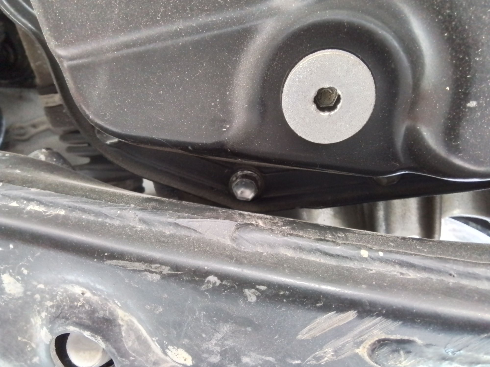

I know where's my question /s. Here we go - all those fluid and filter changes it was most difficult to get one trans pan bolt out being the motors lower "Cradle" is in the way making it quite difficult to get that bolt out, now with all that said is there a simpler way to get it out other then a # 10mm box end wrench as a socket doesn't have room enough for it?
Here's 3 picture's showing that bolt which is just lower left of the drain plug.

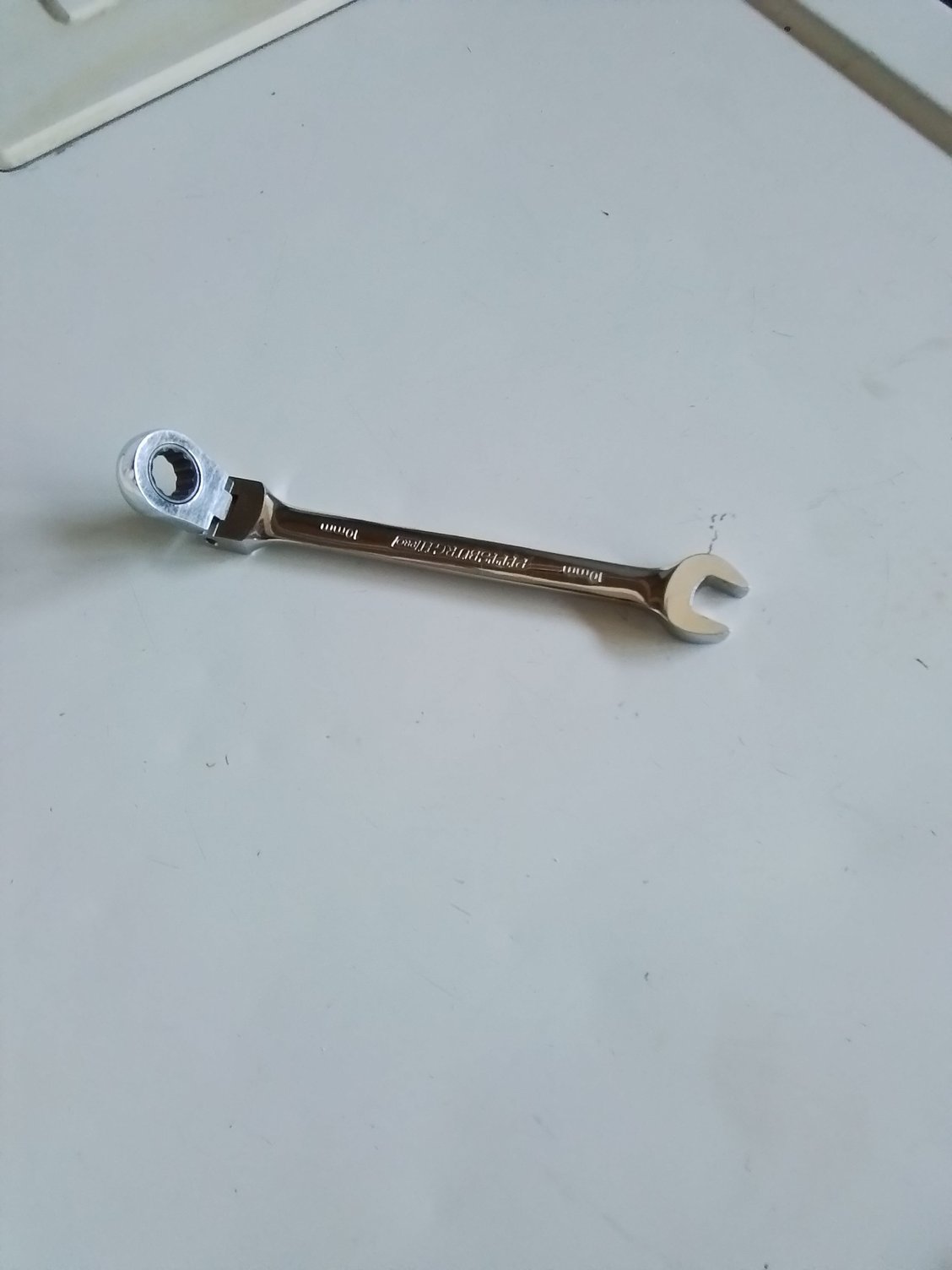

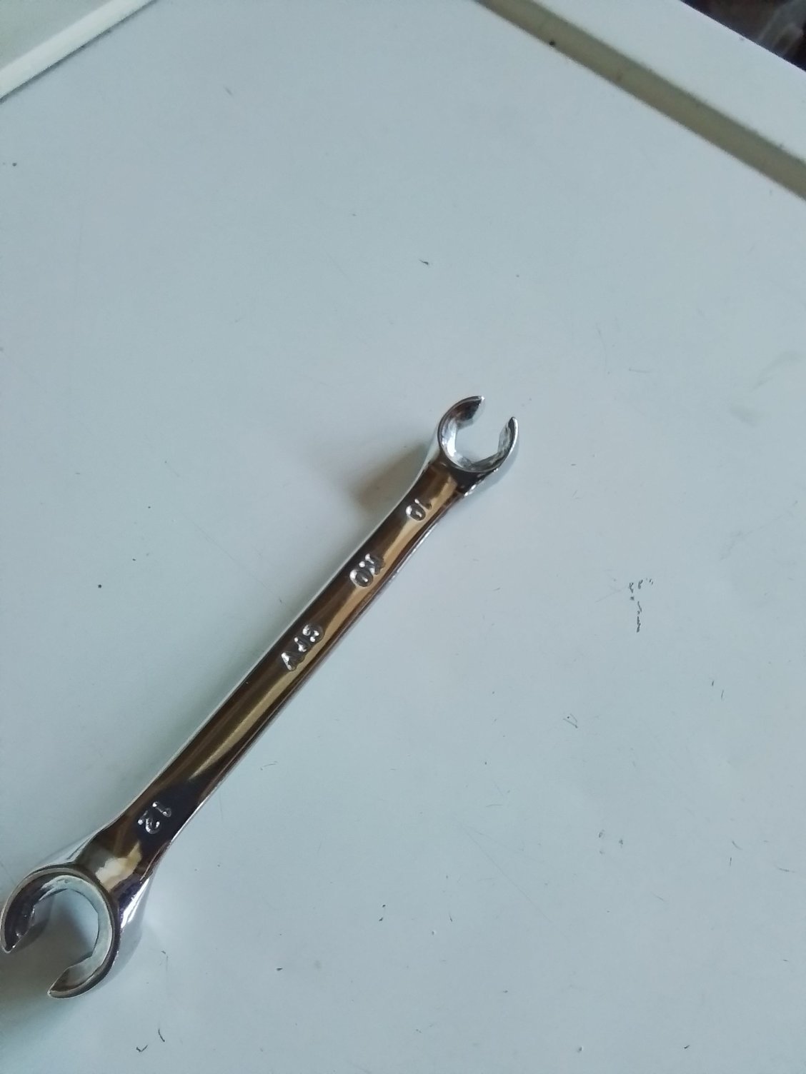

Here are two wrench I've tried with no success.

No - there's just enough room for a box end wrench and the bolt is 1/2" tall when extracted so that's all the room that's there. That/a swivel socket doesn't have the right angle that bolt is further in from that part of the engine Cradle leaving a severe angle for a swivel socket even a 1/4" smaller size one.
Ether the tool is something very special or the motor has to be raised up maybe an 1" or so.
Thinking on my next filter change I'll grind back/off that lip so a ratchet box end wrench can be used - should have thought of this 3 filter changes ago. But still thinking the Dealers Mechanic has some kind of special tool that they keep it Secret.

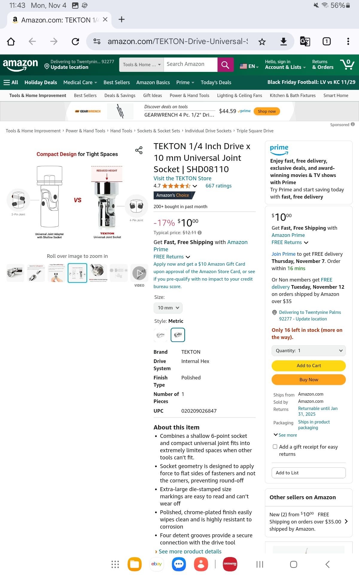

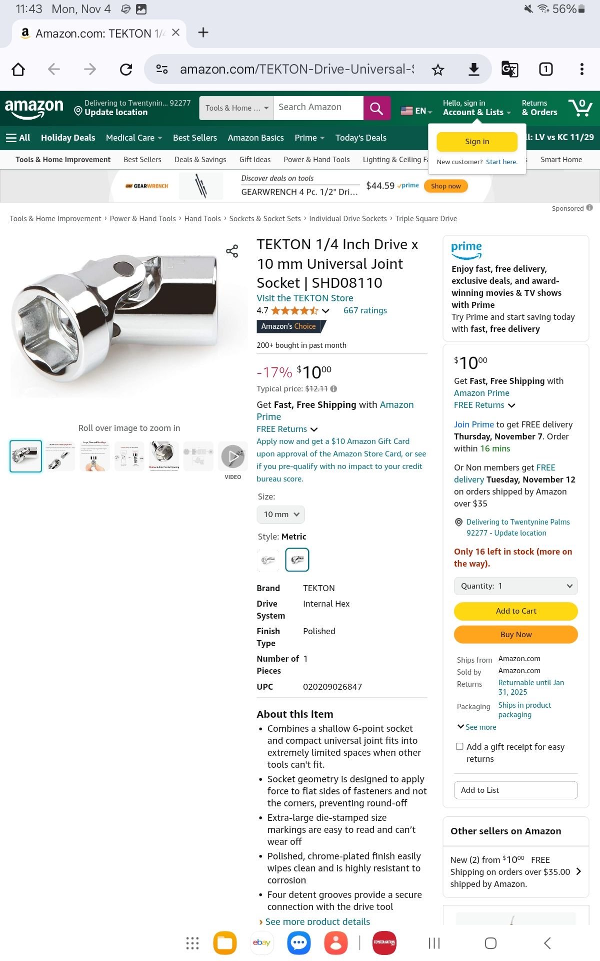

This is what was said to use over on another Toyota Forumn. Similar to what was suggested above this Tekton tool is shorter overall. I got one coming from Amazon so I'll see how it works out for me. And it's built differently shorter obviously and at the center area it's "u- joint is also shorter then the one suggested above.

Actually the TEKTON wobble scoket got here yesterday so jacked up the Camry supported it and gave it a go but it only fit when "without" loosening any motor mounts and just lifting it up at the transaxle just lifting maybe an 1/8" or so it fit so I unloosened it and tighten it back up.
Thinking on loosening up the nut off that motor mount thats right next to the area not all the way and see if it raises easier. Going to have to wait as Temps are falling to the mid 30's..
