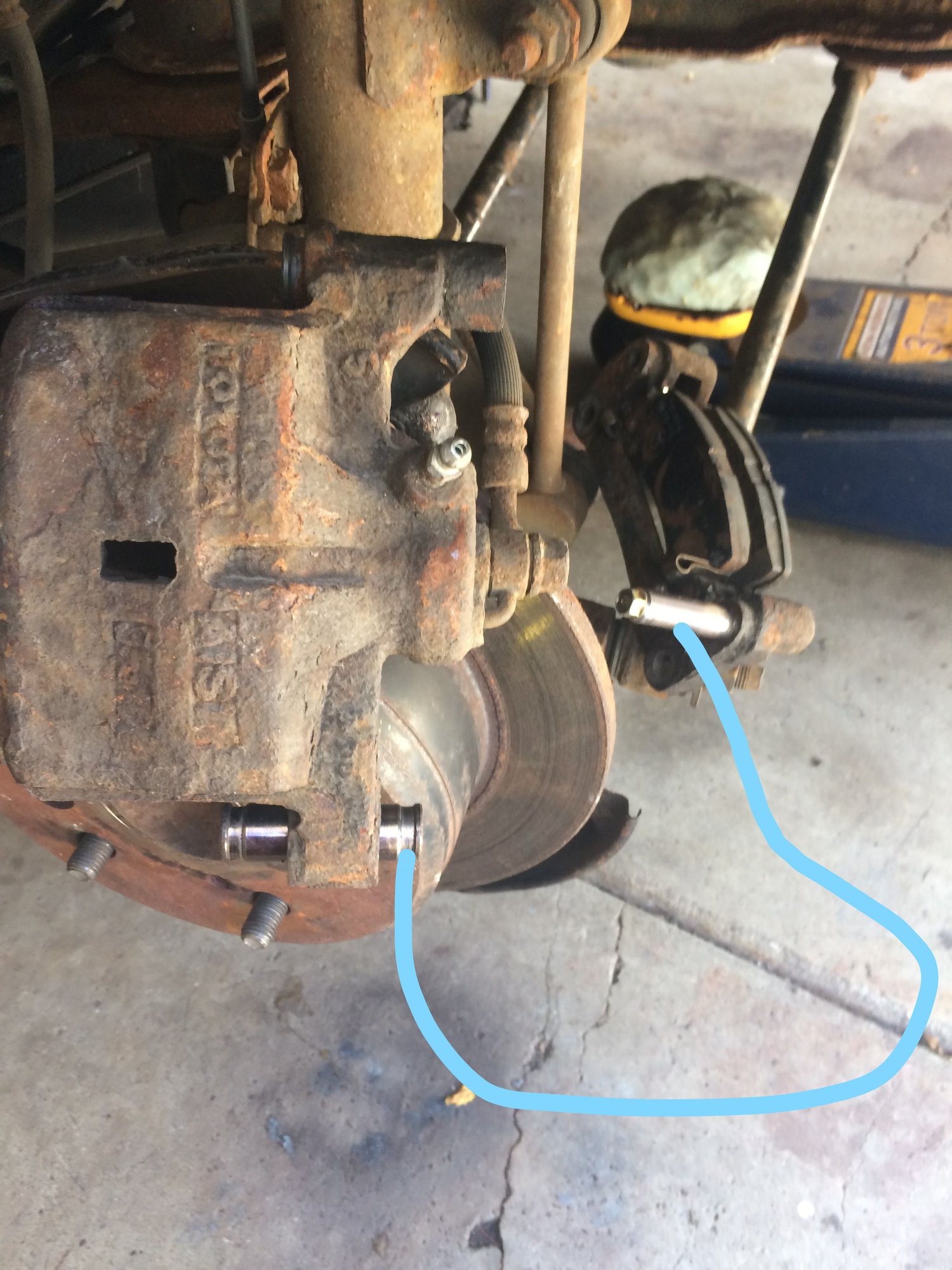

Actually trying to adjust emergencies correctly first. Also there is a slider on the caliper that should slide and was frozen in there. Look at picture The dust covers enlarged due to using petroueum instead of non petroleum lubricant. You can see the two sliders one on brake pad holder and one on caliper Caliper slider had to be hit out. The dust boots were highly inflated and tore off for the most part. Does this make sense. Thanks? Metal has a bluish tint.
