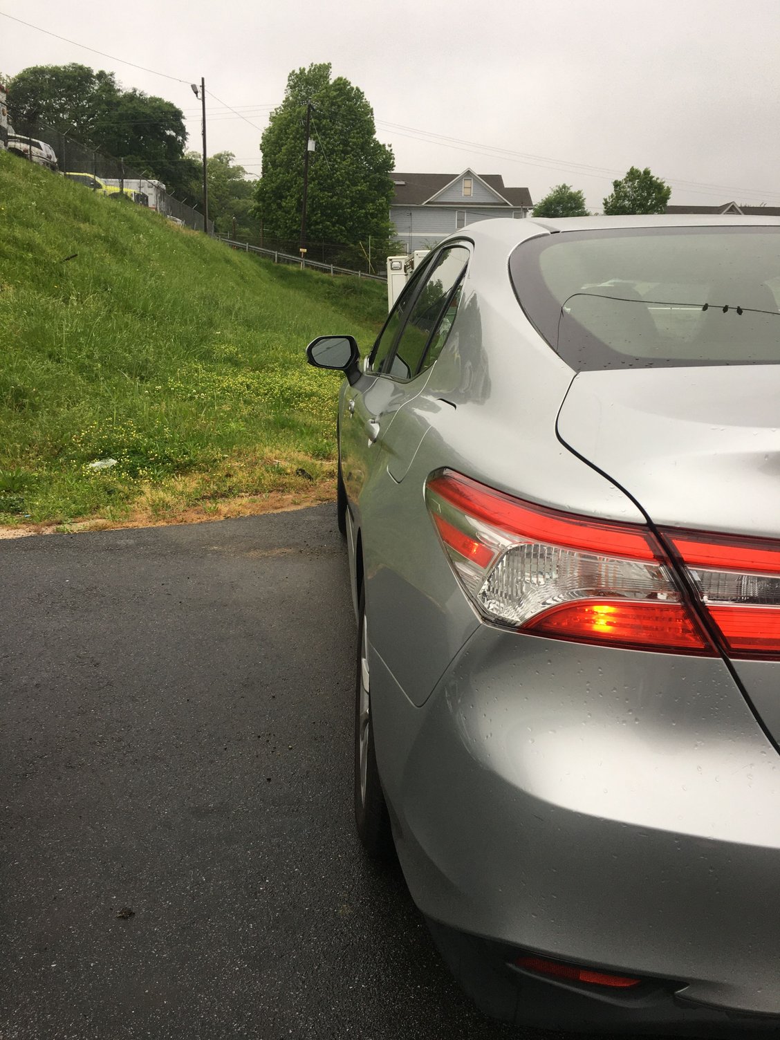

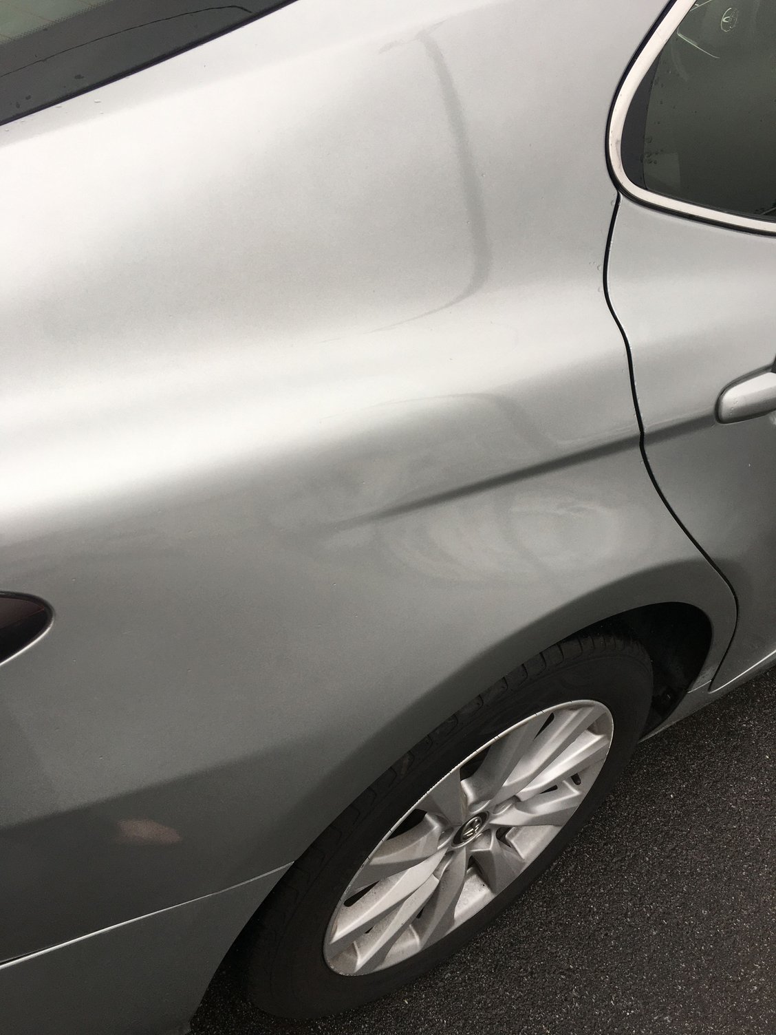

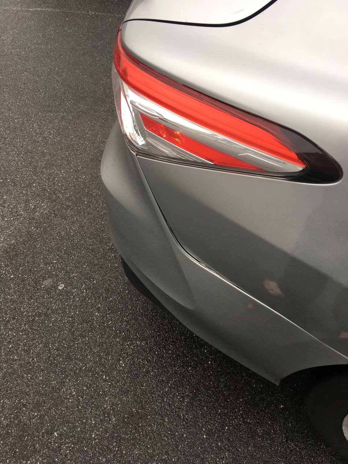

Drivers side: Undamaged side
Passenger side: incorrect curve, according to mechanic
Dented panel
Previous picture’s panel, sitting with bumper
Sorry for poor lighting. Let me know if additional are needed.

Does the body have a dent? If so can't see it.
The drivers and passengers sides mirror each other. If the car was supposed to be damaged on the passengers side then this side can be compared to the drivers side. This includes paint color, paint texture, gaps between body parts, etc.
Get a tape measure and check clearances such as fender to tire on each side and compare.
Review the article at the link below then do comparison.
https://www.samarins.com/check/bodycond.html
View the paint and body under good sunlight and watching the light as its reflected off the car.
As to the car pulling left or right this can also be related to road conditions, tire pressure and tire alignment.
